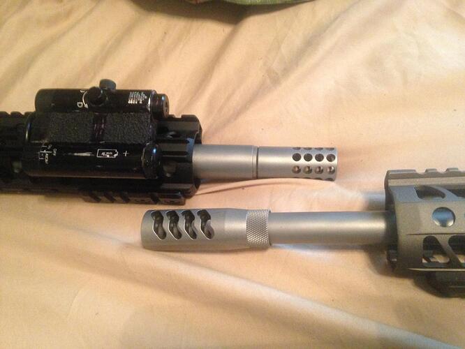

After bead blasting a barrel is there some type of clear coat or something along those lines that I need to applyto prevent it from rusting or will gun oil suffice?
stainless or cmv 4150?
cmv 4150

Not so sure about that. One of those barrels is stainless and the other is not. Look identical to me. Guess I’ll order some clear cerakote or something along those lines
It should look like a bead blasted stainless barrel initially. I would guess that it wont stay that way very long unless it is clear coated, or generously oiled. Rust will get to it pretty quick otherwise. This is the reason most, if not all, chromoly barrels are parkerized, or oxided. Park is a good finish for oil to saturate into and protect the steel from rust. Even if the barrel is painted, Park still makes a great substrate for the paint to adhere to. Assuming you just want to blast and clear coat it, bead blasting is not going to give a good surface for the clear coat to adhere to as it creates a smooth surface. Al-oxide blasting will give a dark and rough surface for a clear coat, or paint to adhere to raw steel.
