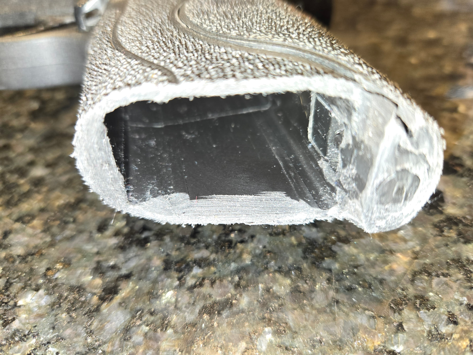

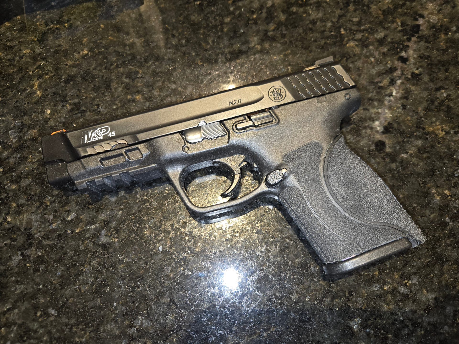

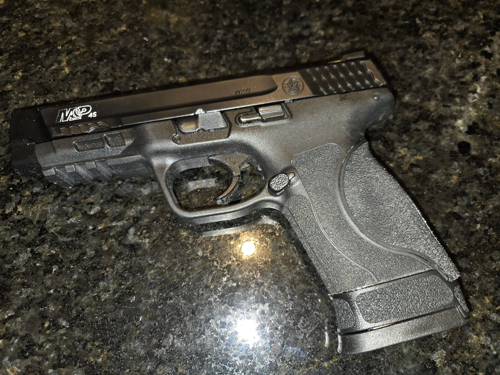

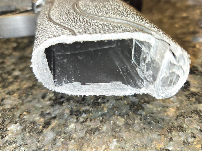

The close-up looks terrible. :sweat_smile: But the chop does everything i wanted. The backstrap is still changeable. It just takes a screw driver to access the square window in poke the retaining rod to rotate and then push it out.Pics are of a 10 rd mag with spacer & 8 round “Subcompact” mag.

Yea, it looks like crap close-up. :grin: works perfectly despite my “tool marks”. :laughing:

Not bad man. That’s a whole lot better than I was envisioning.

After chopping the flush mag used is M&P Subcompact mag, it holds 8. I can just barely get all fingers on it.
The longer mag with spacer is a 10 rd mag.
