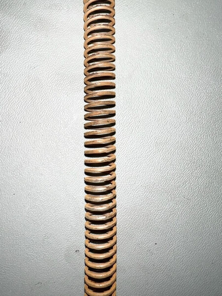

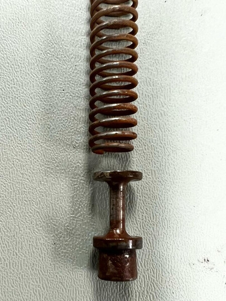

Note: The Remington 1187 was found to have a very rust corroded recoil assembly. This gun was found to have a very rough and sticking action. The agency who brought it had used one of the microbial solvents where you soak the gun in the cleaning solution. This drove the point home whey you need to disassemble for cleaning, and not drop entire assembled guns into tanks, as if you don’t get the solvent or fouling out then it creates problems. Once cleaned up well, they were supplied a new recoil spring assembly which was installed, and the action started working much smoother.
