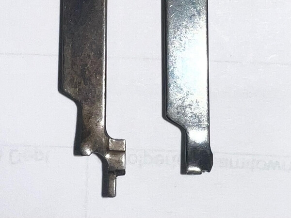

Note: One 870 had a bent shell latch that was causing issues when trying to manually cycle the action, and was also causing an issue when removing/installing triggers and bolts. Upon inspection the shell was inspected, which was bent and out of alignment, but when it was removed , it was found to be broken on the front tip. We supplied him with a new shell latch, which allowed everyone to see first hand removal, installation, proper indexing, and staking.

Pic of the broken 870 left shell latch (New on left, broken on right for reference).
