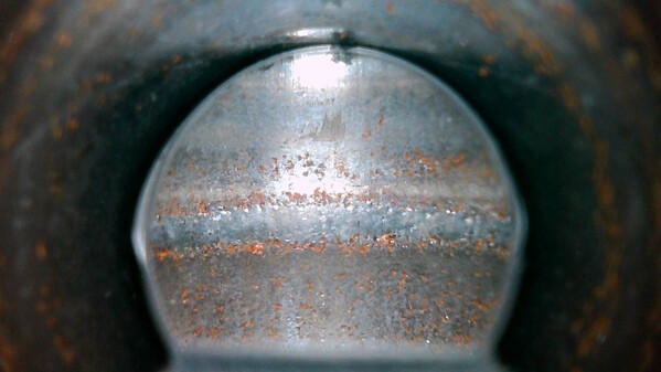

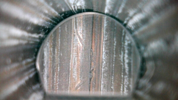

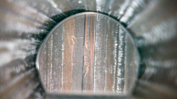

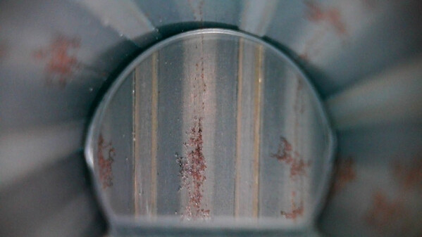

Everyone was given the opportunity to borescope their barrels. This is a great time for everyone to see what different barrels look like on the inside, and see the damage people create due to the cleaning methods. Most of the rifles in this class were well taken care of. Only a few had damage from cleaning solvents, and cleaning methods. Several people got a good look inside their suppressors with the borescope, which drove the point home about cleaning them for best performance and longevity.
Note: When borescoping barrels, a 700 barrel was found to have rust. Another 700 PSS was found to have some flaws in the factory rifling, which looked almost like squiggly grooves in the barrel, a guess is that ie was caused when the rifling was cut. One of the Tikka’s was found to have some pieces of the red tips from the ammunition that was in the chamber and bolt lug area of the receiver.
