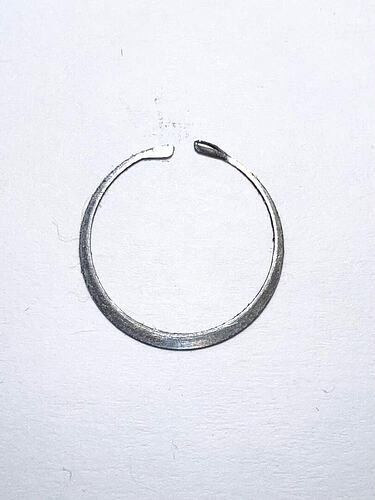

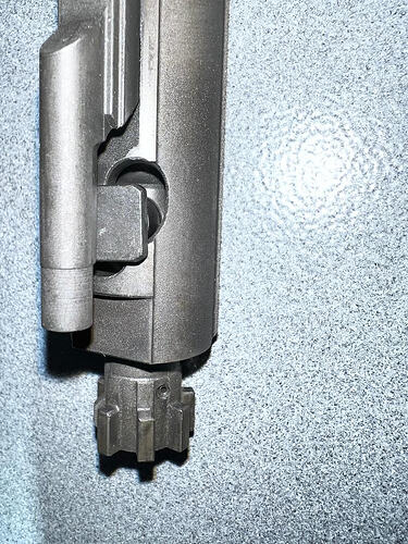

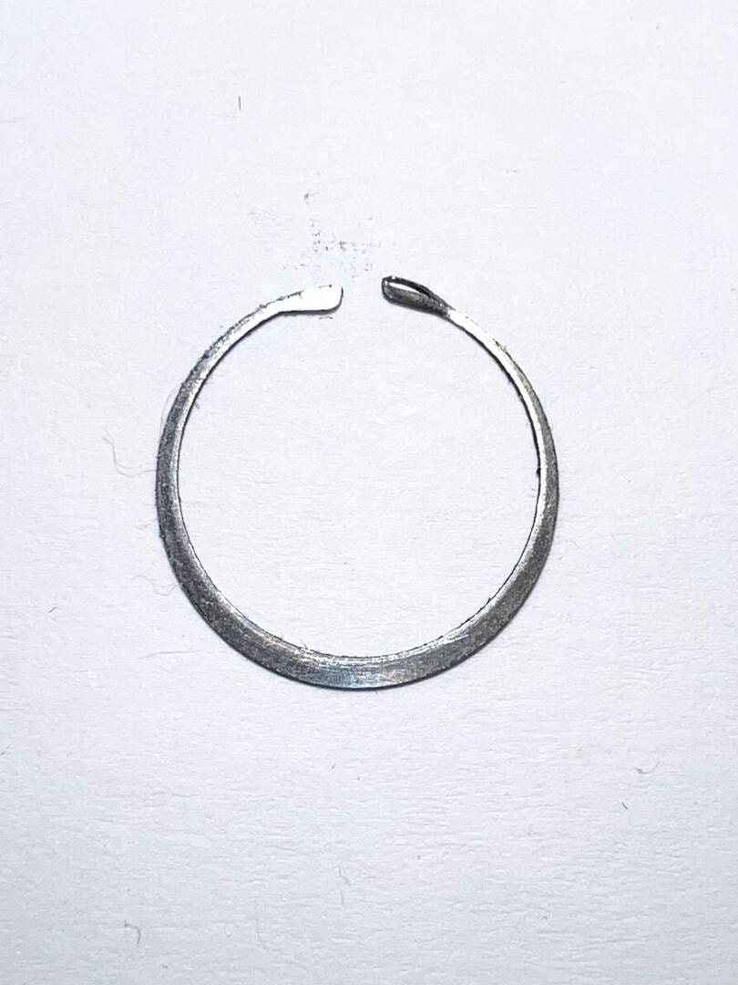

Note: There was a new Sig M400 which the Officer could not get the cam pin out. The gun only had 200rds shot through it, and basically looked new. Upon inspection the bolt was getting stuck, and wouldn’t fully rotate enough to allow the cam pin to align to clear the gas key. With a little effort, I was able to get the bolt rotated enough to get the cam pin out. At this point the bolt didn’t want to come out of the bolt carrier. I was able to force it out, and upon inspection the bolt carrier was found to have a burr of metal on the inside at the gas vent holes. This burr of metal was getting bound up with the gas rings, which actually had deformed the gas rings. Iwas able to do a little polishing work and get the burr of metal out, and also supplied the Officer with a new set of gas rings.

Here’s a pic of the stuck bolt before I was able to force it apart.
Pic of the gas ring that was catching on the gas vent hole burrs
