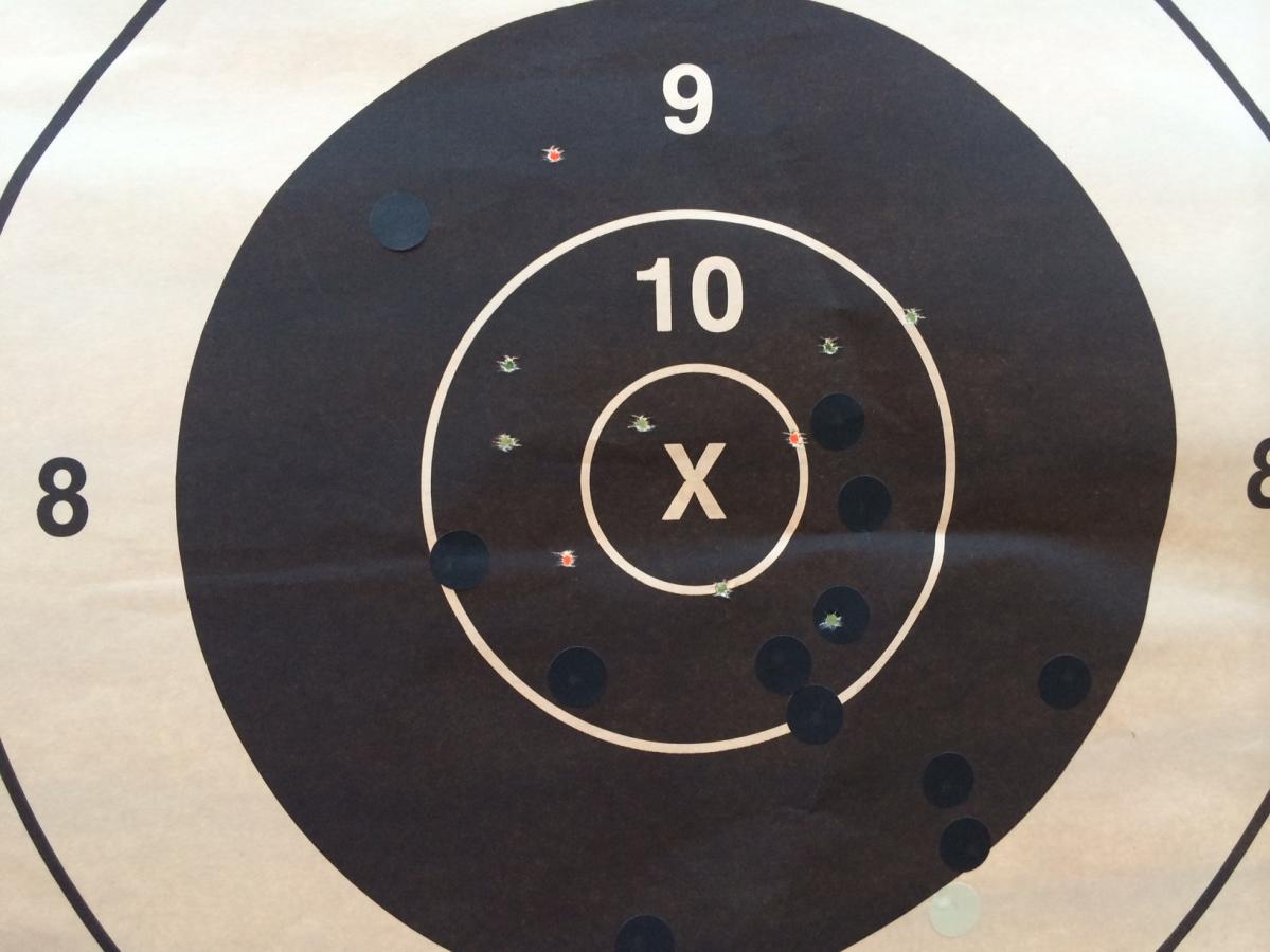

At the risk of coming across as a snob, My response would be “tight enough to consistently “clean” the X-ring on an NRA high power target sized for the distance you are shooting”.
Below is my “rapid fire” group shot at 300yards in 60secsonds with a magazine change, prone, shooting irons, sling supported:

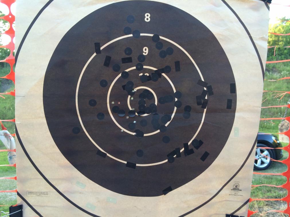

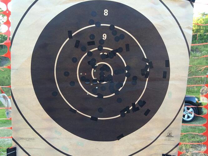

Below is my 200yard “rapid fire” group in 45 seconds, with a magazine change, sitting, sling supported, with iron sights.
While those groups were shot with a free-floated NM AR-15, I see no reason why this can’t be duplicated with your rig if properly supported with sand bags.
For reference, the x-ring is 3inches, 10 ring is 7 inches, so we are not talking benchrest groups here.
