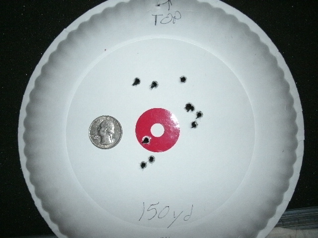

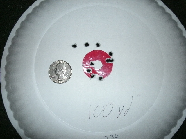

Here are some targets, 100y and 150y with basic bulk ammo from my tricked out 10/22.
If your happy with the results and can find it whenever you want I say that’s a great ammo choice.
