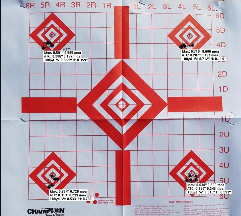

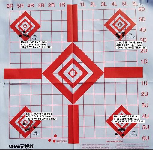

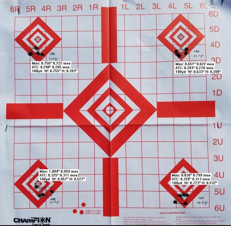

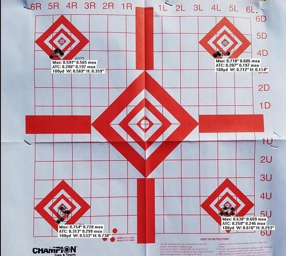

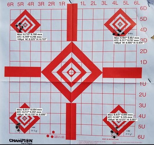

I’ve really only shot groups at 100. Best 5 round group has been .4 moa. .6 to .7 moa is pretty typical in reviewing my targets. An occasional inch group when I suck. Other than that it’s mostly shooting steel for fun out to about 600. I’ve got probably close to 2000 rounds on the barrel. Here’s a 10 round group from 3 days ago. I find 10 round groups to be difficult so this is good for me.
ETA some 5 round/ 100 yard groups I have on my phone.
