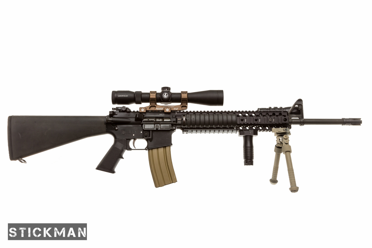

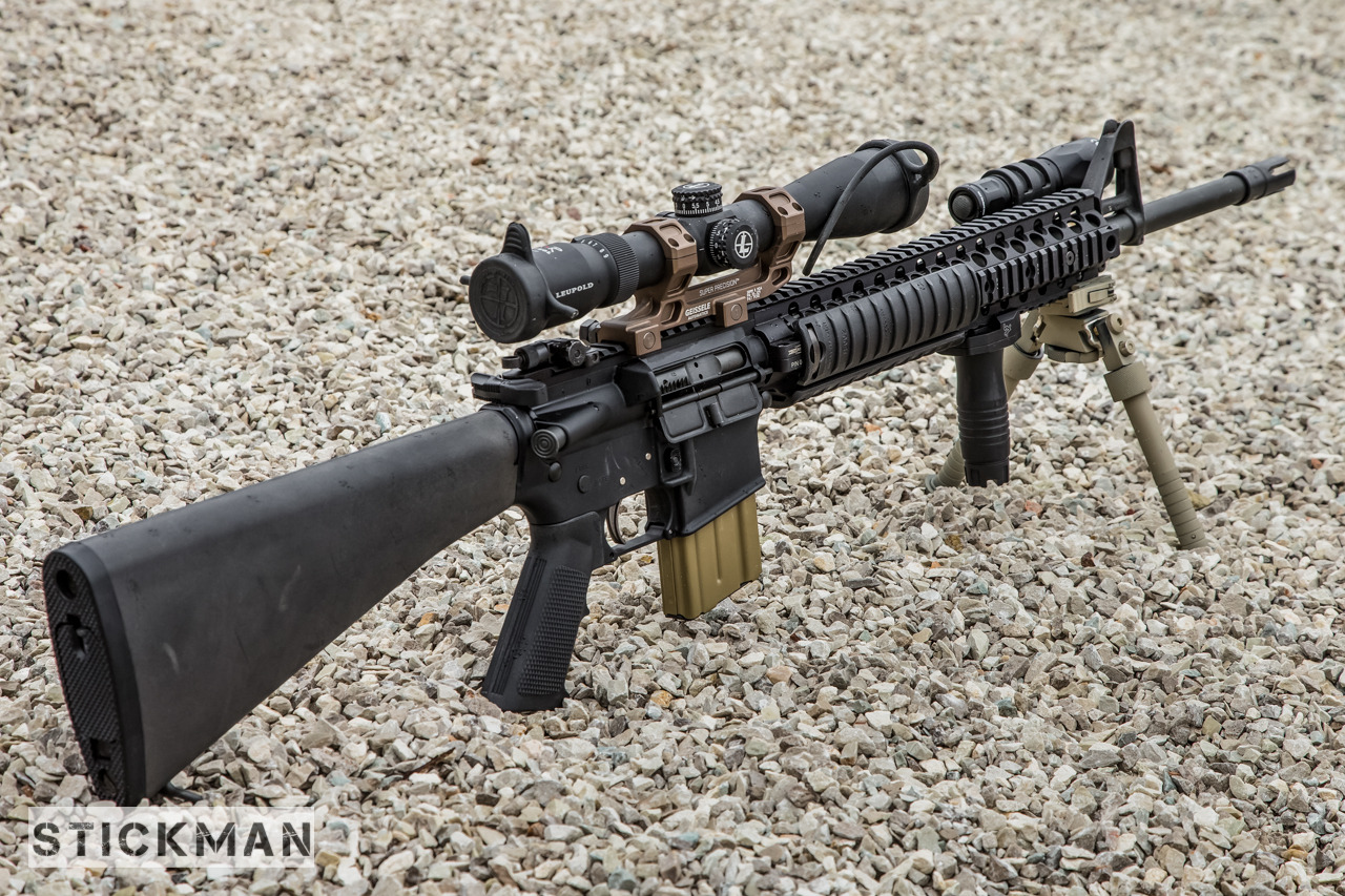

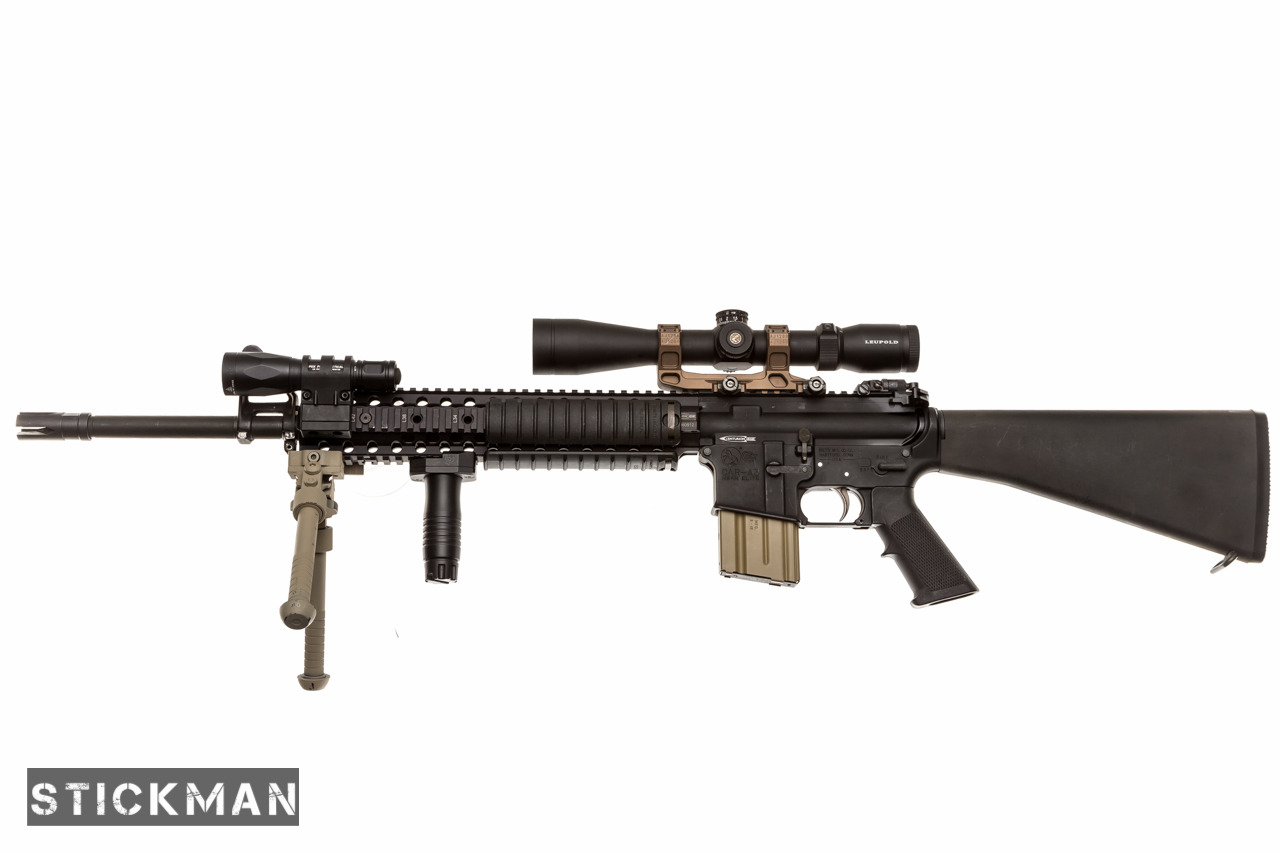

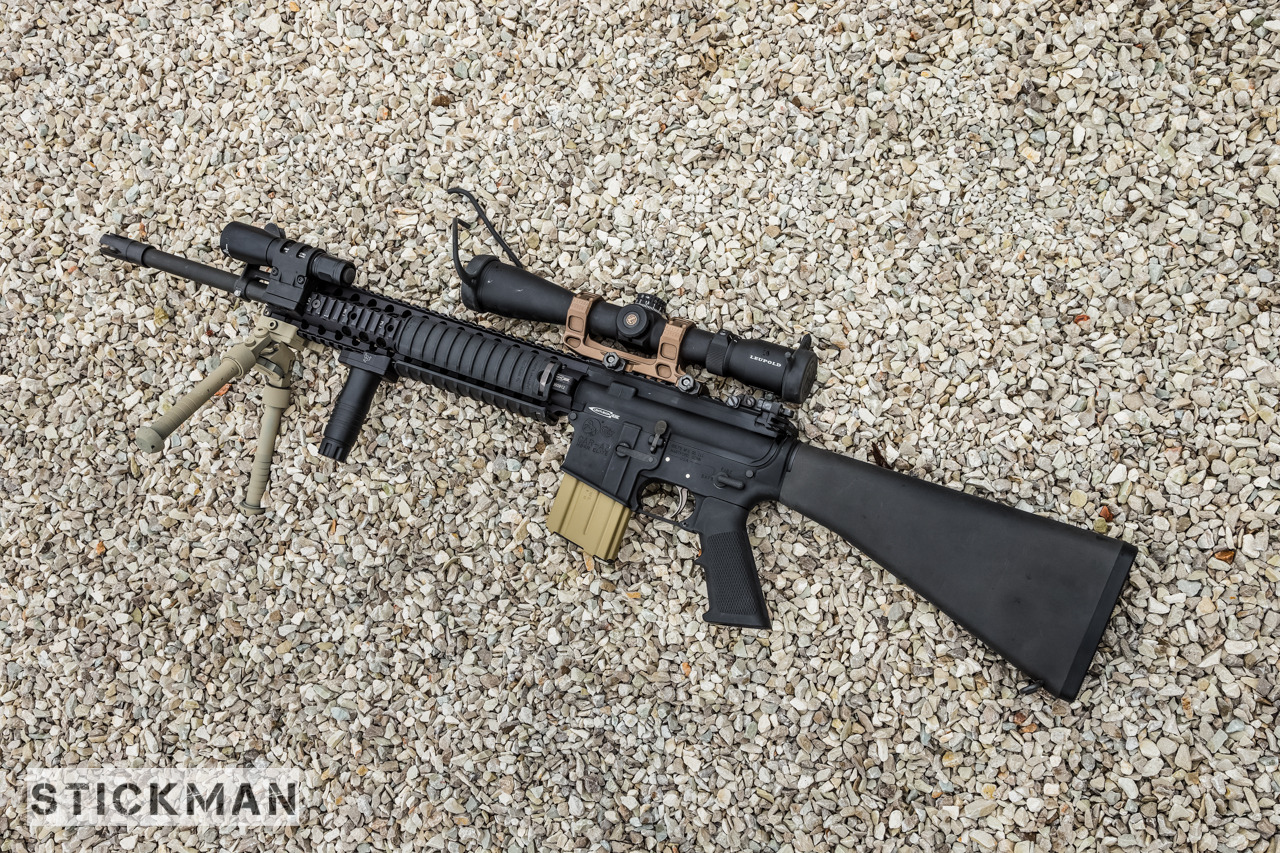

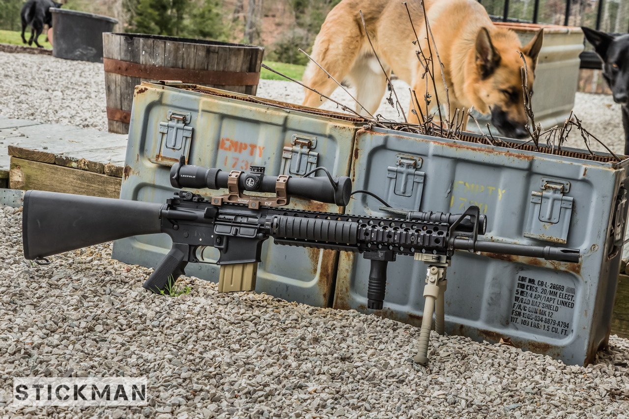

The primary purpose of this build was to implement a weapon that would launch 55 grain projectiles out to 500 yards in an accurate manner. Why 500? Because that is pretty close to max distance of the steel on my personal range.
Starting with the lower, it is a Colt receiver with a Colt “match” trigger. However, I’ll happily point out that this trigger is no where near a Geissele, nor near the newer Centurion Arms 2 stage, it is a clean single stage trigger. However, it is a step above a generic trigger. The buffer and spring are standard components, nothing special. The stock is an A2, and while I do prefer the A1 stock, most of the shooting with this rifle will be prone so it isn’t really an issue. The charging handle is the extended BCM (second gen). The safety and magazine catch are standard components, nothing special, no ambi on the platform. The muzzle device is a 4 prong from Centurion Arms, and is only installed hand tight.
The upper receiver group is based around a 20" HBAR 1/7 Colt barrel complete with Front Sight Base (FSB). The BCG is a Centurion Arms, as is the rail. The rail is the Centurion Arms C4 1913 model, which completes an overall military look to the weapon. The receiver is a flat top (A3/A4) made by Centurion Arms, it was chosen because I wanted to stay with a military style receiver and the CA had a very tight barrel extension to receiver fit, which helps to maximize accuracy. The gas tube is standard, there was no need to alter gas flow with this project, I figured if there was, I could swap gas tubes or restrict the port with a plug down the road. The rear sight is KAC, though the scope mount is not QD.

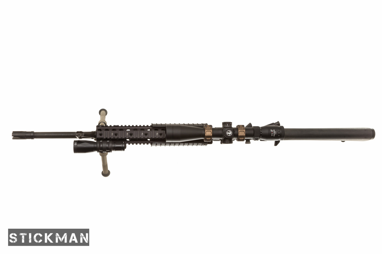

The accessories have a Geissele super precision scope mount holding a Leupold 3-9 VX-R Patrol scope. The optic isn’t perfect, but it functions well enough for this project. The “fire dot” is bright enough and is motion activated.

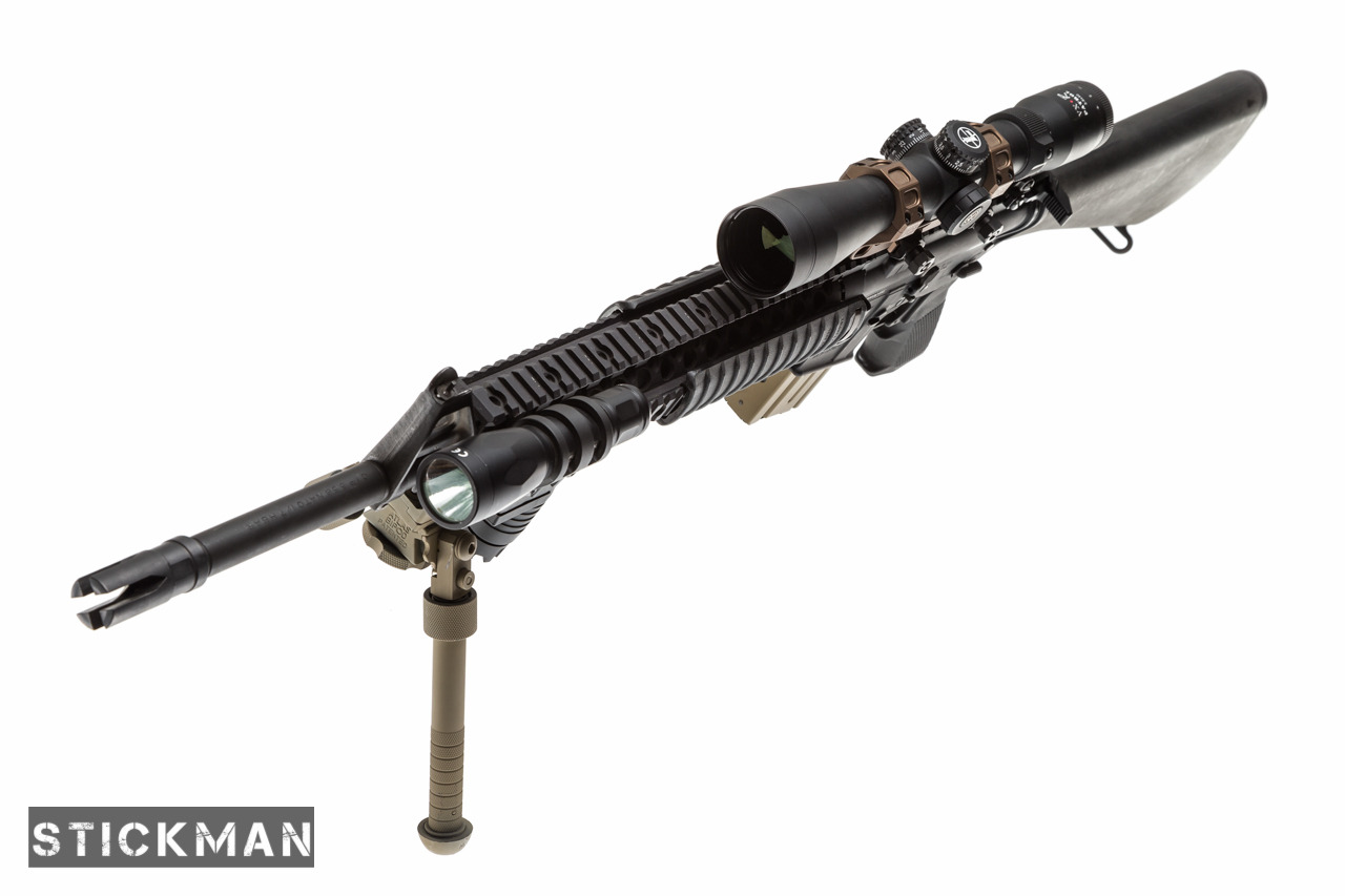

The light is a Surefire handheld model in a Viking Tactics light mount, its on because I like the throw of the light. There is barrel shadowing, but it is held to the 4 o’clock position and not so much as to be objectionable. The VFG is a modified Bobro Engineering model which I cut down. The bipod which is currently on it is changed out from what is shown. There is nothing wrong with the bipod shown, but evidently I’m used to the Bobro Engineering bipod so I swapped back to what I’m comfortable with. Balance on this is noticeably more nose heavy than a M16A4 due to the HBAR, however, recoil is a soft gentle lullaby of a push.
The end result of this project is a vehicle for a wide variety of ammunition, and the platform is going to be limited primarily by the scope and my own shooting ability. I call this project, a total success.

Nice looking build with all quality components. I’m sure it is up to the task with an HBAR 1/7 for 500-yard pops with your new gun project. We shot my HBAR with irons last week and it was big fun. Mating Centurion and Colt should be a win-win, enjoy. Keep us posted with different loads and accuracy.

That’s part of why I left irons on it. The scope may get pulled for other projects, and it’s always nice to be able to accurately make the gun go bang. Speaking of which, I’ve been banging steel with my A2 mil contract upper. I have really enjoyed getting back to basics using iron only weapons.

What reticle is in the Leupold?

Good question, it’s a fire dot, but I’ll need to check the box to see what it’s called.

VXR Patrol 3x9 all come with a TMR reticle, a nice simple mil-hash. It is bit thicker than on non firedot and of course with the illuminated center dot rather than open.

Is that the 12" C4 rail Stickman?
Yes, the C4 12" fits rifles and is what is on this build.
