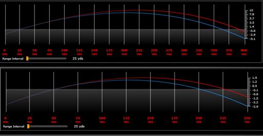

20ozjolt, I hope this is what you’re looking for: it’s from Winchester’s trajectory calculator app: the red is 62 grain 223, and the blue is 147 grain 308, both FMJ. In short, the trajectories are pretty similar but you’re going to see 308 a little short of 5.56. This is with standard FMJ, again. I’m sure you could see something different with match ammo and all that.
Here’s a picture to give you an idea (the bottom picture is a zero at 50, and the 308 comes in about 25 yards shorter at 300m).
