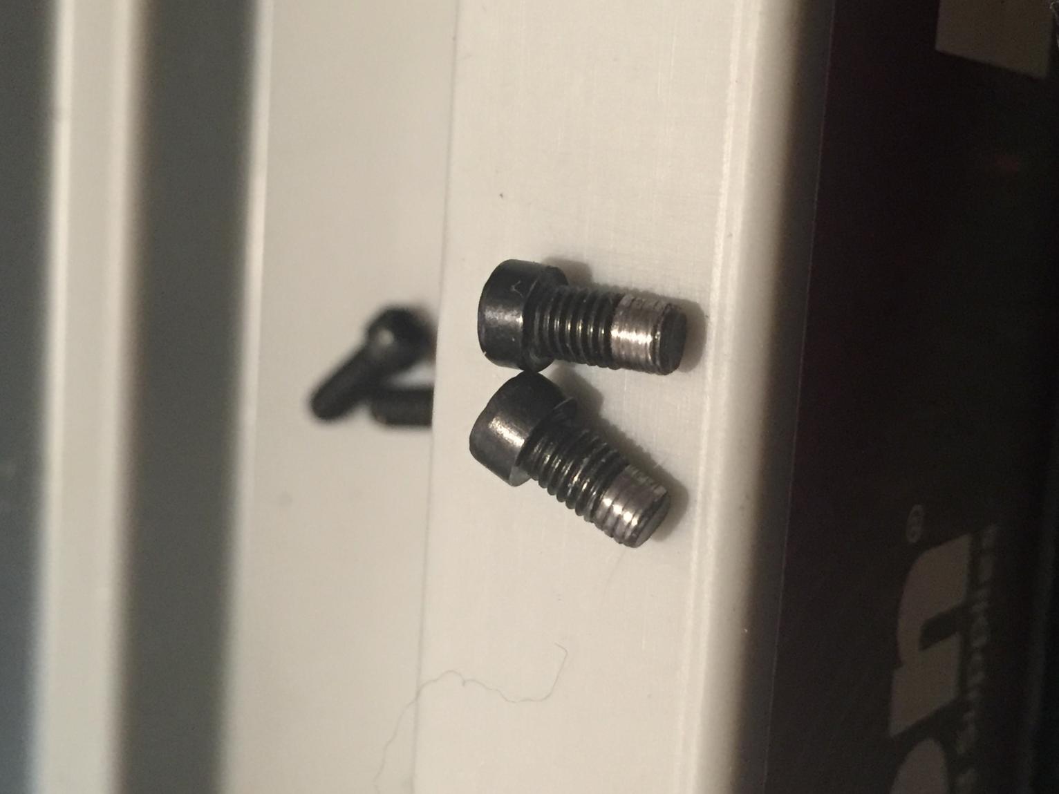

Think I found the issue. The forward most base screw is stripped. The next one on the same base was partially. You can see the silver part of the screw and how it’s smoothed out. Interestingly the fromtnbase didn’t move a bit when I tried but I suppose my attempt is not as effective as the kick of a 300 win mag. Now I need to find replacement screws.
Those screws look really, really weird. Only time I’ve seen that is when I forcefully screwed a screw into a hole that wasn’t fully threaded. I would make sure the receiver holes are fully drilled and fully threaded, and don’t have metal shavings or something blocking the threads, before putting new screws in. Best way to do this is with a tap of the correct size. Those aren’t too expensive to buy, but depending on your skills and preferences you may want to take this to a gunsmith.

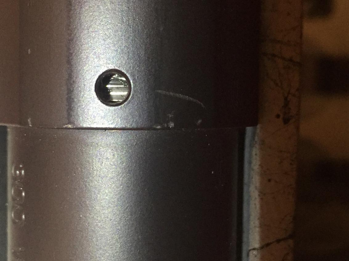

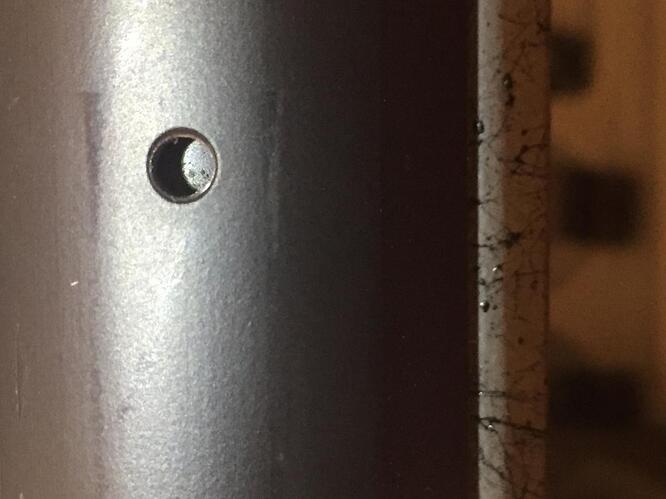

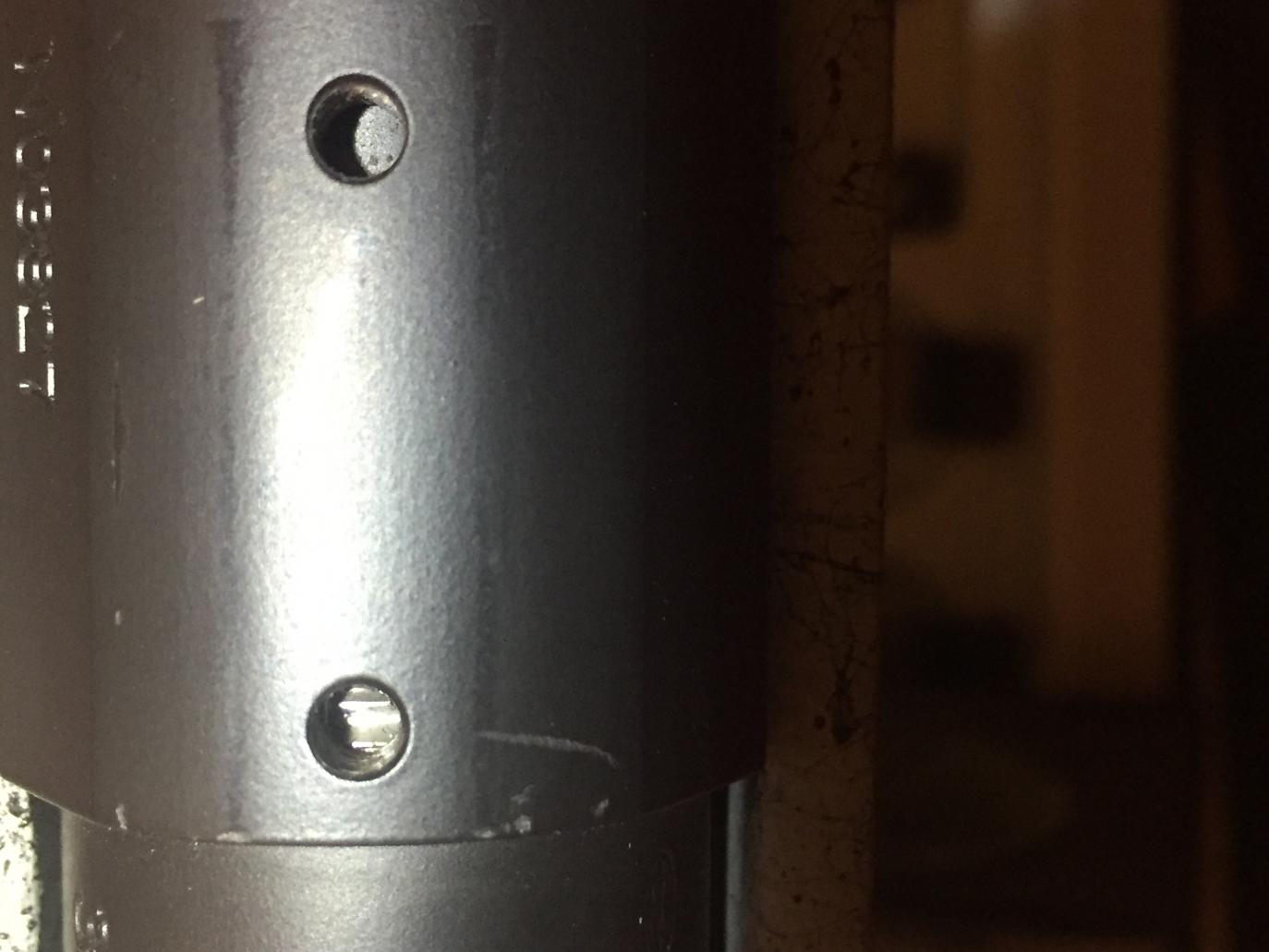

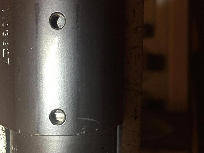

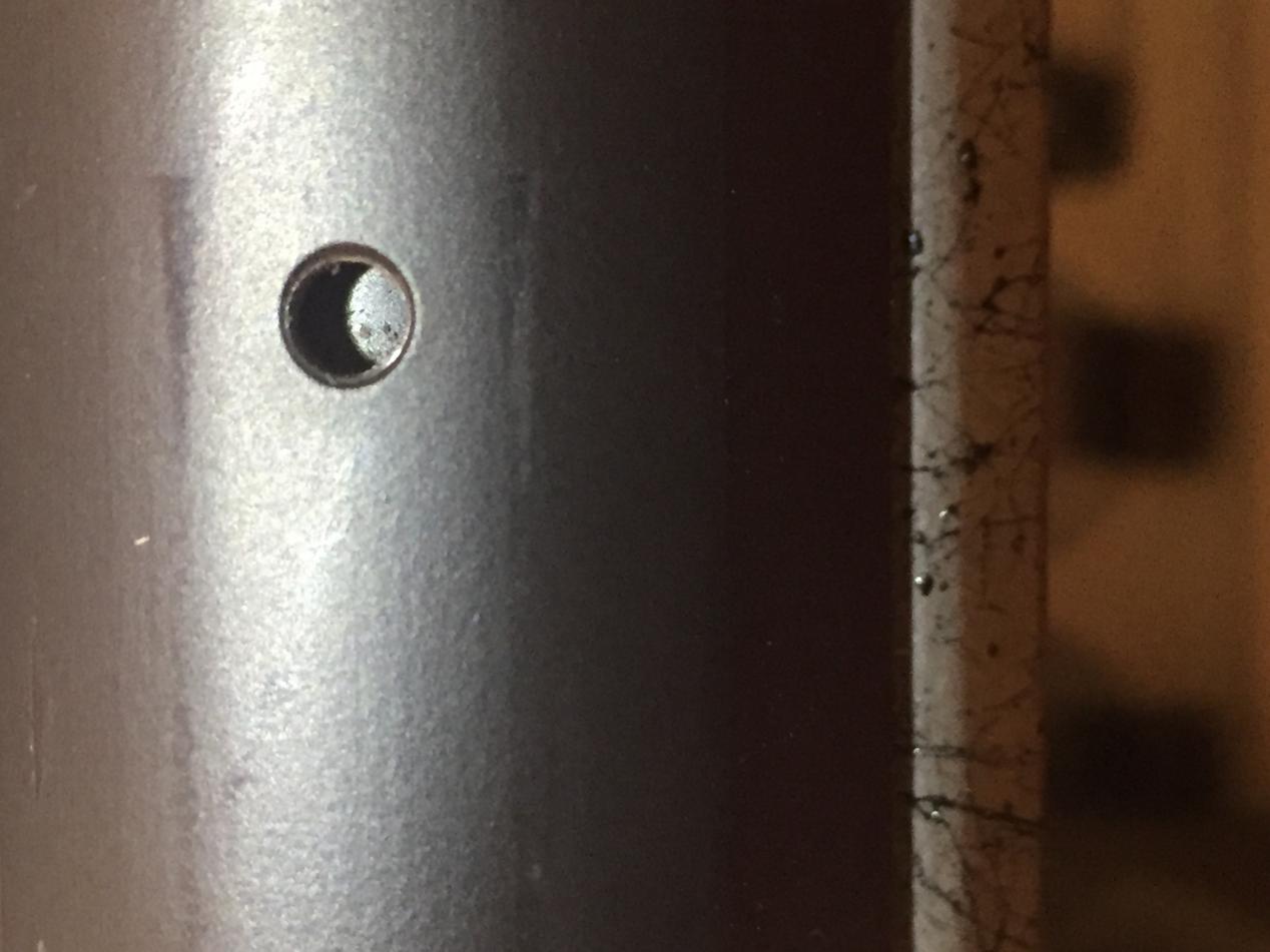

Here are pics of the holes. The front one has shavings in it. The back one is pretty clean. No visable shavings at least
Both (front on bottom)
Front
Back
