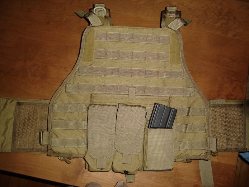

Seriously, are there any dealers that can let me know what size the plate carrier is? I would really like to know. Thanks!
Take measurements from side to side across the bottom and from top to bottom and post them or call/e-mail the manufacturer.
My S/M EPC has six rows of PALS webbing. Yours “looks” like an Eagle also and has seven rows. I’m gonna take a SWAG and say that yours is a L/XL.

The S/M has 6 rows of PALS webbing, and is geared toward 8x10 and 10x12" plates (trapezoidal only for the larger sizes). A 10x12 rectangular plate will not fit in the rear carrier.
The L/XL has 7 rows, geared toward 11x14" trapezoidal plates.
Four rows of webbing above the cummerbund, that is a L/XL. The S/M only have three rows.
