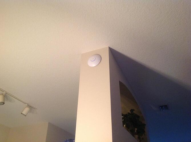

I have just the Router X and one Unifi AC access point. I ran the Cat5e in the attic to a central location near my kitchen and mounted horizontally. I get good signal 100’ away in the corner of the farthest point in my backyard. You will need to program the AP with a PC using their Unifi controller software, but it isn’t hard if you know the basics.
The Router X has never needed to be rebooted once. It can do a lot more than the consumer routers can as far as advanced features, but I really don’t use them. If you have a big house or non friendly wireless construction, you can have more than one AP and use the Unifi controller software to control them and manage the handoffs.

The long range just puts more power to the signal. It all depends on your needs. They have the pro, lite, long range, outdoor models , etc.
