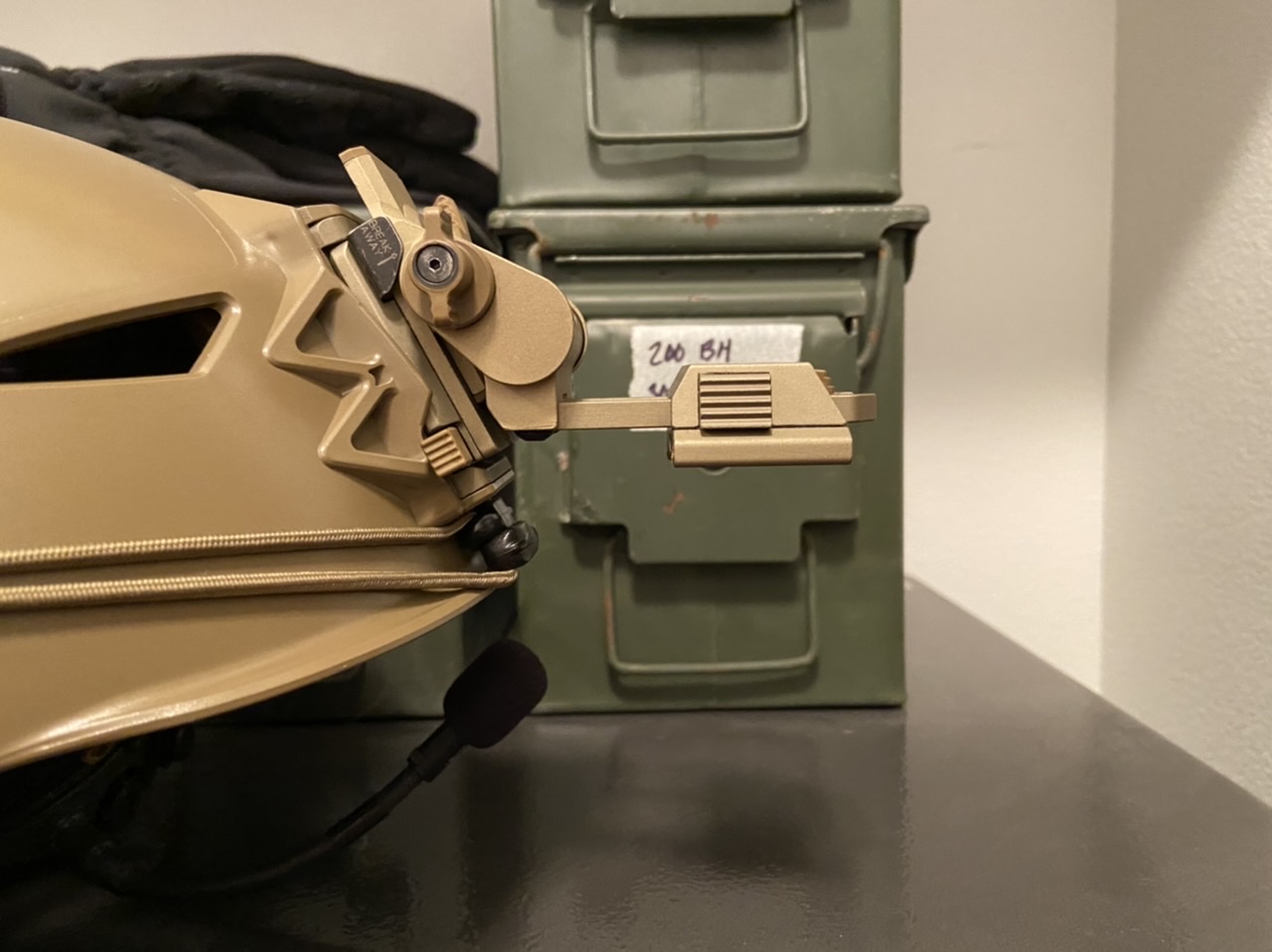

I have an exfil LTP with a G24 and to me it looks like mine is can get higher than the rhino and the mounting interface is a lower profile, therefore a bit higher. see photo thumbnail. I suck at posting pictures

Thanks for the pictures lahunter57, it does look a bit higher.
