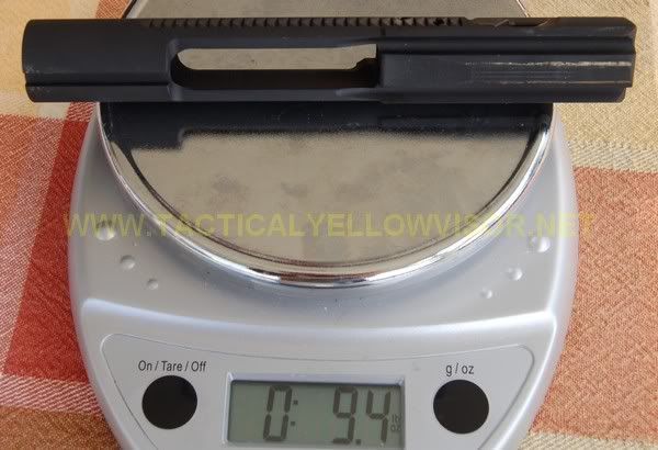

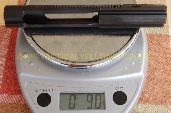

Yes, this is correct. However with SA carriers getting more and more material at the rear this becomes less and less of an issue. I would still rather have the auto, but at 0.4 oz difference… (and there are semi carriers that I’ve seen with even more meat than this)
