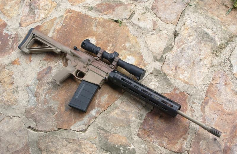

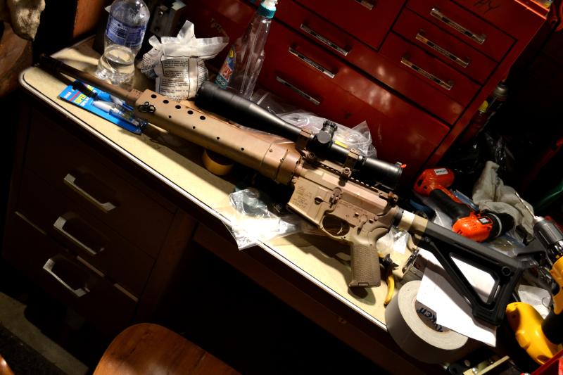

  1. With A1 stock would look similar to this:
  2. With MOE stock would look similar to this:

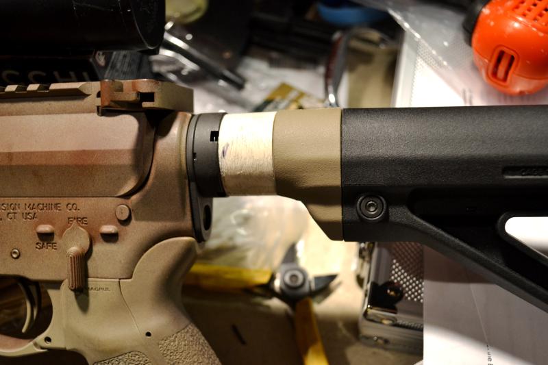

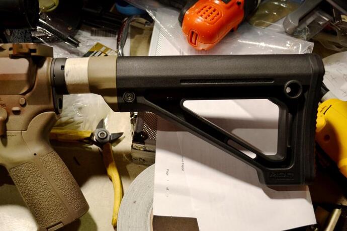

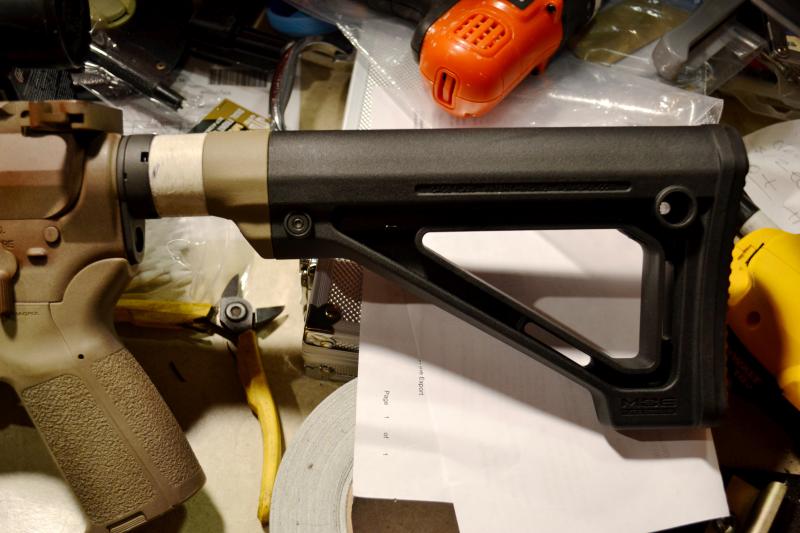

For the build described, I would use the Magpul Fixed Length Carbine stock with a thick pad and make a spacer, if needed, between the front of the stock and the plate. In fact, that’s exactly what I’m using on my 20" precision AR.
Pic please
A little different than what you are asking about, but my Dissy has a MagPul fixed carbine
I used PVC pipe to make the spacer. 20 inch precision
I did the same thing on an MP-10
