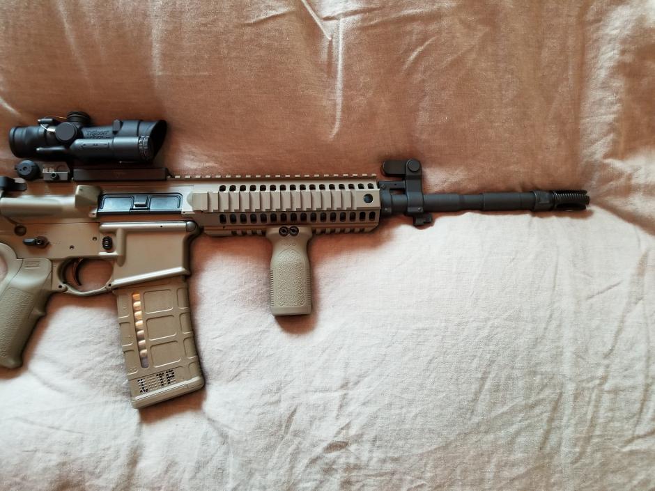

I have a non-mount AAC Blackout pin/welded on my LMT 14.5 - https://www.advanced-armament.com/BLACKOUT-Non-Mount-Flash-Hider-556mm_p_449.html
The blackout is nice, little concussion and it’s very effective as a FH.

26 Inf has it right if you are looking for the best flash suppressor (plenty of videos available testing flash hider efficiency). I am using the Smith Enterprise Vortex on my Colt MARC 901 (OEM) and pinned on my Colt 6944 (14.5") so I can still mount a bayonet (old school).
