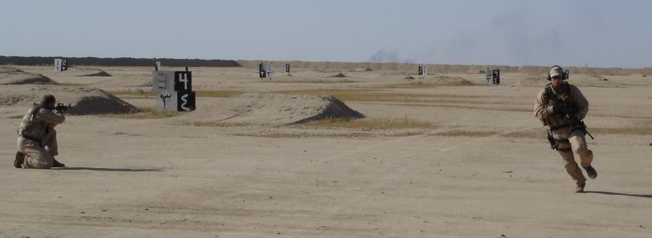

The brits I work with like to point it upwards if they are doing a mag change on the run, for instance while pepper popping away from a contact. It is easier to change the mag than pointing down, and it tells your team members that you are changing your mag. In this photo, a team mate is running back with the weapon pointing down.
