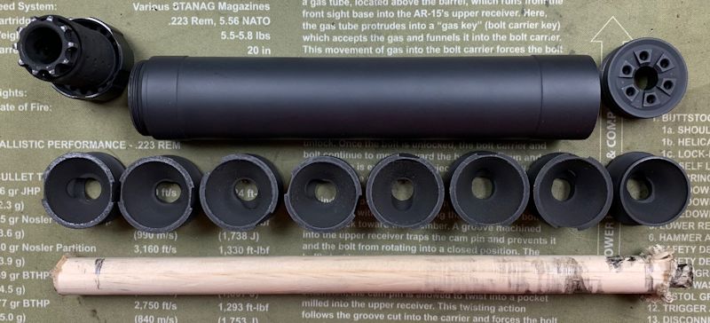

I disassembled my TiRant 9 suppressor for the first time since I purchased it. It probably has about 1000rds of the NT (non-toxic) Federal American Eagle 147gr TMJ through it. I followed the instructions to disassemble it. The instructions indicated that I would have to “gently” tap out the baffle stack with a 5/8" dowel. Not so. I had to pound the crap out of the baffle stack with the dowel until they all eventually came out. It actually does not look overly dirty to me.
Now that I have it apart, what’s the easiest way to clean it? I really enjoy guns, but do not at all like cleaning them. I’m definitely willing to spend money on contraptions to avoid effort.
