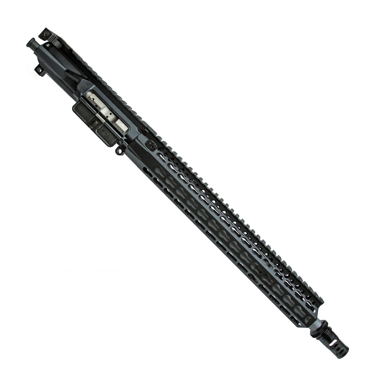

As received from Rainier:

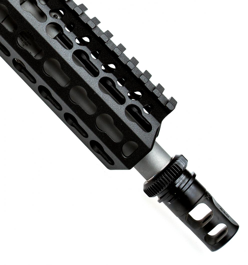

AAC Brakeout 51T:

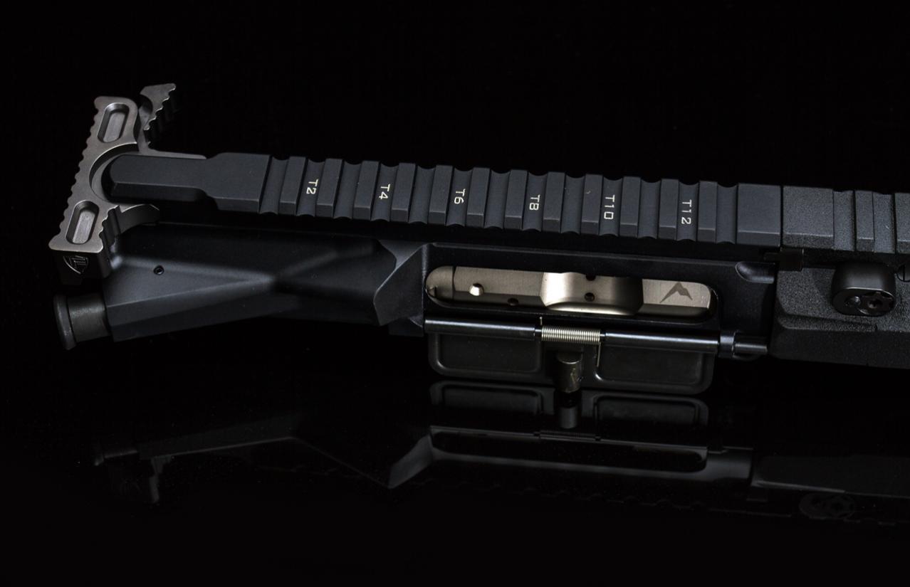

Rainier Upper, BCG and Fortis Hammer:

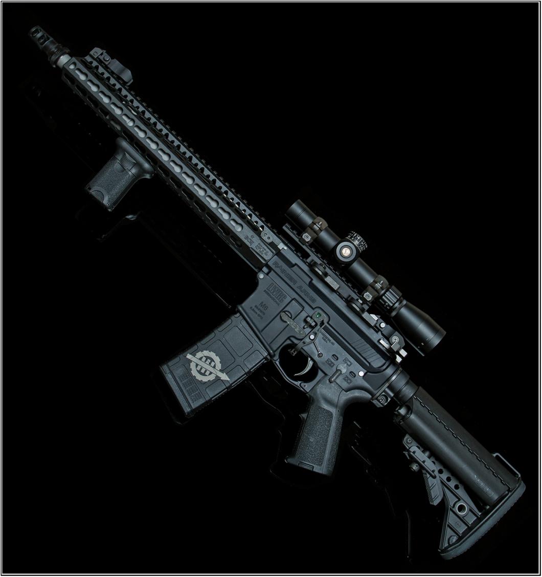

Completed upper on the LWRC SBR Lower:
