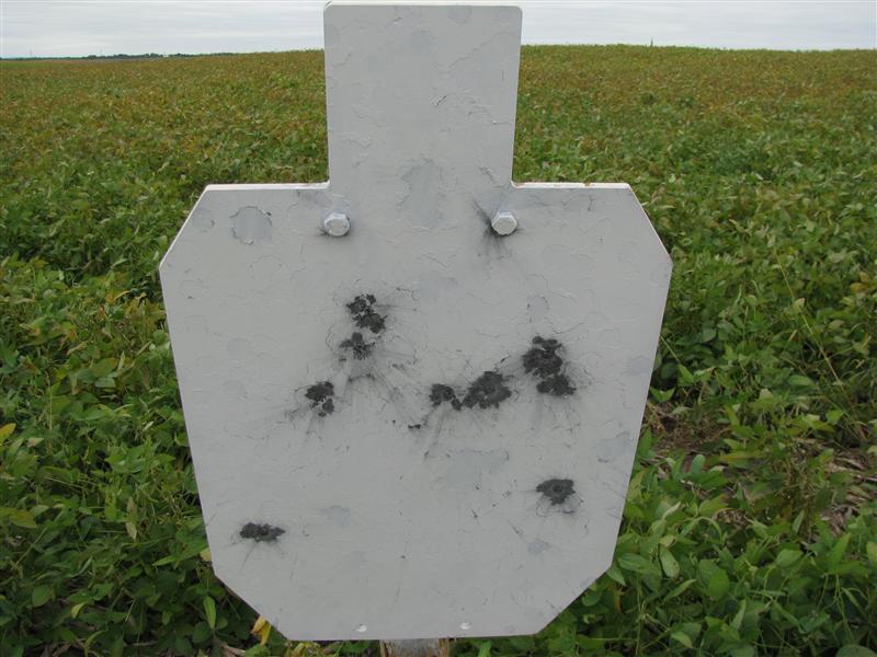

10 hits on IPSC at 750yds with my sps tactical in HS stock. Ditch the hogue stock and you’ll be happy. :slight_smile:
