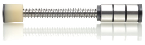

I recently purchased a [b]JP Silent Captured Spring[/b] set for my 300 Blackout and I ended up loving it so much that I’m ordering one for every AR that I own.
My particular reason for doing so was more for reducing the amount of felt recoil and noise created by the original buffer spring on my suppressed AR.

I tested the JPSCS with the extra spring pack, a suppressor, and an adjustable gasblock… the results were not favorable. The SCS has too little buffering action so the cycle is violent. The buffer is 3oz anyway; same as a carbine.
