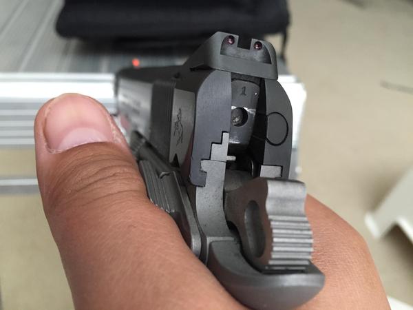

Looked at the back of the gun an saw this:

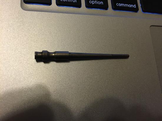

And the firing pin looks like this:
It look like it got flattened out and no longer fits in the hole in the firing pin stop.

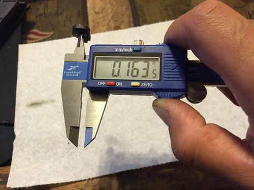

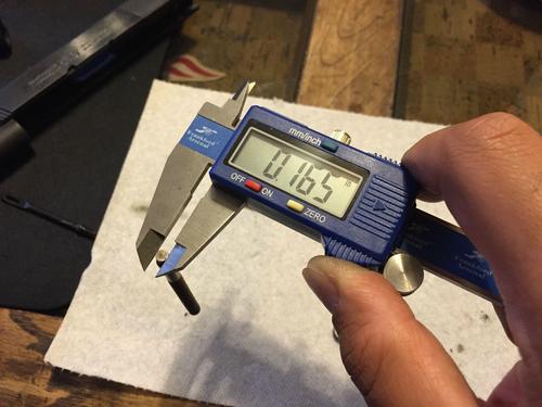

Sizes:
It’s a series 80, so there’s that. It only has 973 rounds; 900 of my reloads and 73 Federal HST 230gr standard pressure (tried to get to 100.).
Any ideas on what caused this? Those first 900 were trouble free.

The firing pin is too soft and it peened.
Throw it away and get an EGW or try another Colt.
I had a plain series 80 that did that while dry firing. Stuck forward with no apparent damage. I bought a Wilson BP unit just in case. Never gave me any trouble after that.
Perhaps simply the metal is too soft. I’ve never seen it deformed like that, even when there is some obstruction to its movement due to the FP plunger being out of time. Also when the FP hits the plunger there are very easy to notice marks on it.
Yeah you need to look at the notch in the firing to pin and see if it’s peened. If it is, then the firing pin block is not clearing the pinin time.
I installed a Colt N plunger lever in every Series 80 I ever had.
Try this:
With the thumb safety engaged (on), pull the trigger and press the back of the firing pin to see if the firing pin block is raised enough to clear the firing pin. It should be. If it’s not, disengage the thumb safety and see if you can get the firing pin block to clear the pin before the hammer falls. If you can, then it’s timed correctly. If not, order an N lever. They’re about $5. I used to get 'em directly from Colt.

I don’t see any peening. Thank you for the tip.

Tried this, and it worked how it should.

Has anyone actually checked to see if the Series 80 guts were actually there?

I can tell by your picture that your firing pin is peened down on the back end. You said the firing pin safety works, there’s really nothing else it could be. This is not an unheard of occurrence with Colts.
