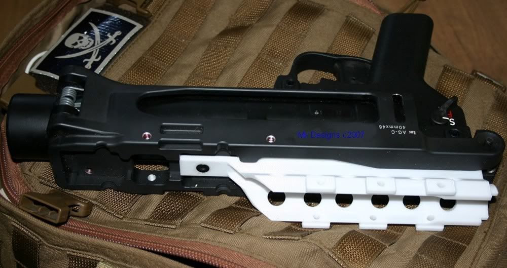

The Hk AG/C (sometime called the AG-36) mounts to a pictanitty rail and the bayonet lug - and has caused a great number of problems in that respect (cracking front sight gasblocks etc, KAC made a special lower locking M4 RAS section for 22 in this respect).

The H&K XM320 I believe was designed to have the same mounting capabilities that the m203 has, (i.e. either locking unto the barrel nut or be light enough to be rail mounted).
I have a “passing” familiarity with the HK gl.
The intial mount used the bayonet lug to mount and a three pin shelf to lock to the barrel nut. When using a plastic top handguard
This was founf in testing to shatter the front sight gas blocks - so a solid gas block was then used for the UK SOF L119A1 (C8SFW) – as an aside the KAC front sight is durable enough to use as a mounting point.
For using the KAC M4 RAS – the "shelf is removed and it slides onto the M1913 rail section of the RAS – KAC came out with the SAS RAS Lower due to this - as the drop in RAS lower will not stand up to the use as a GL mounting point (keep in mind the M4 RAS is simple retained by pressure of the left and right of the “upper” RAS segment - the delta ring and the forward handguard cap - it was never designed as a GL mount – so the other lower (with some of the RASII lower properties - coldblue would be best for the history and chnages etc. on KAC parts)

In short the Hk Gl CANNOT be reliable straight to rail mounted —
If you do the only thing locking the GL to the rail is a pin system locking thru the mount to the rail – and all the force is directed into those two pins.
