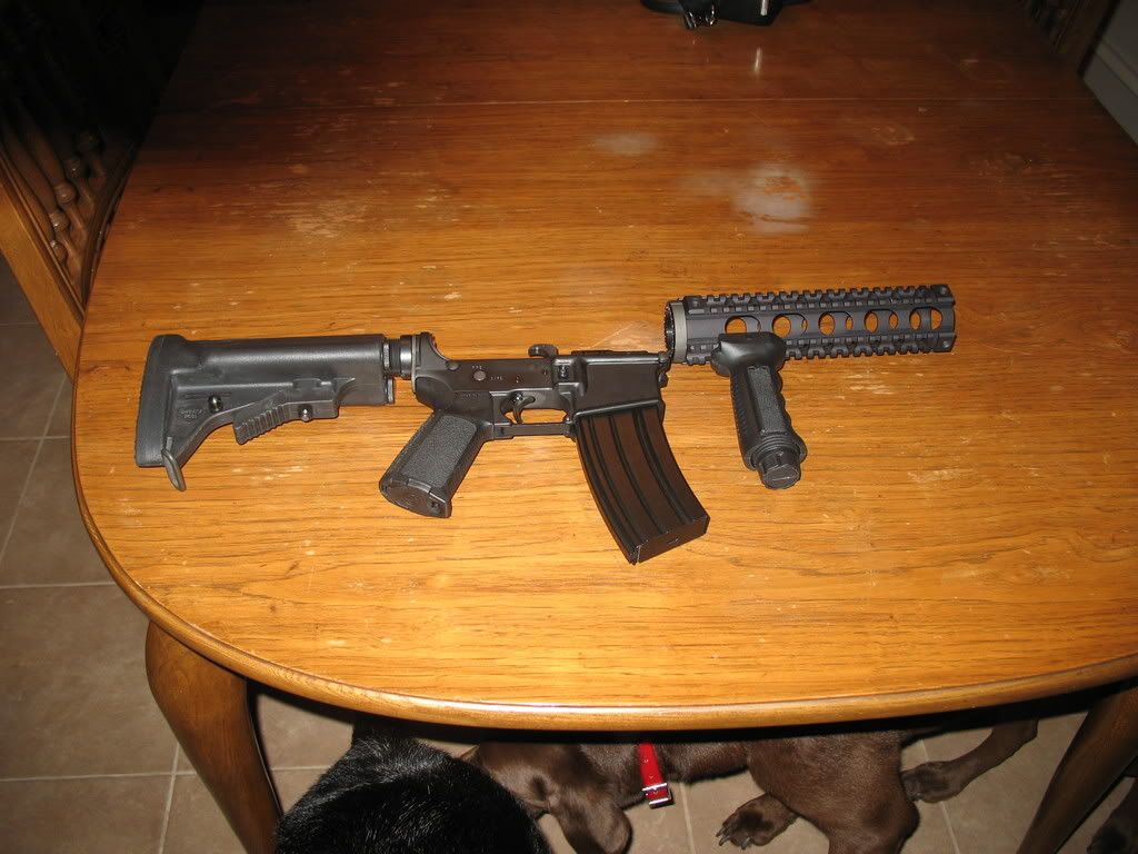

HERE IS MY LOWER!!!
Lower is a CMMG Lower with a Choate machine and tool stock (should have gottin the LMT stock) it also features a Magpul MIAD grip.
can you tell whats missing?

Joe where in the heck did you get that DD rail? Or did you have someone cut it?
I didn’t have anyone cut it especially for me if that’s what you are thinking.
Frankly, I was very tempted to let it go at that since you didn’t give me enough credit to think I might have enough ability to handle that task myself.
I did the cutting and grinding myself and Jay refinished it for me months later after the original tan DC wasn’t holding up to the abuse the KAC clips put the leading edges through.

how do you like the MAGPUL CTR stock??? been thinking about getting one of those as well…
the VLTOR has feed ramps right??? so i need the barrel with the m4 extensions?
Love the CTR stock it is very nice and worth it. Bought it from AIM surplus the same folks that sell ammo. Over all much better than the stock butt stock.
