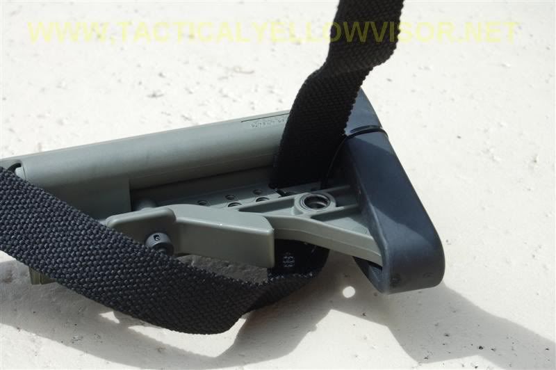

I suppose you could run the sling through the slot on top only but I doubt that would hold up very well. A sling not mounted with a swivel should be run through the slot just above the swivel socket, around the stock, and through the slot on top.

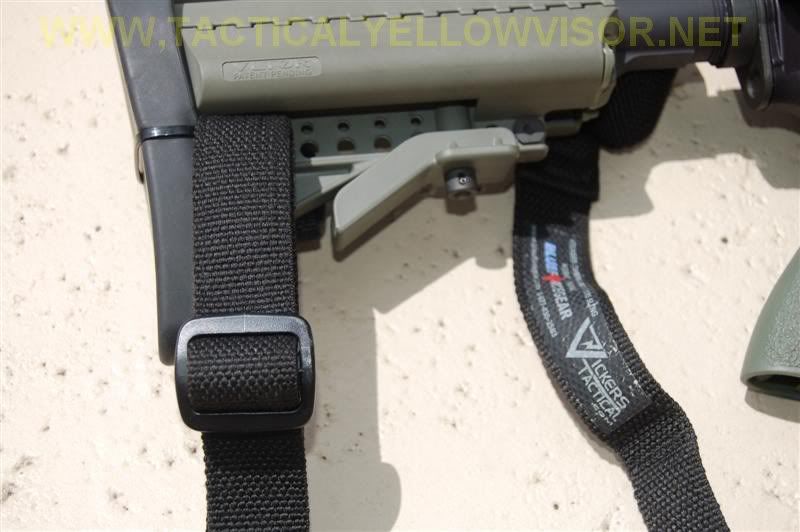

you can’t see the slot with the battery tubes installed. You can see it in this pic though.

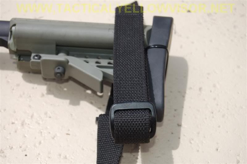

You have to wrap it through, or if its a cord adapter you can run it through the bottom slot and out the swivel hole

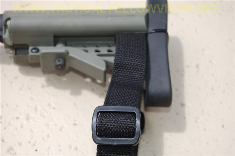

Push it through and use the buckle to keep it from coming back. Like this
I had done the push thru using the buckle to anchor, but with all the plastic buckle gizmos on the VCAS sticking “strait” out into the cheek pathway b/c of the batt compartments holding it all out sideways. I guess I’ll use the top slot (carefully) for my MultiGun shoot this weekend until I get a swivel:confused:

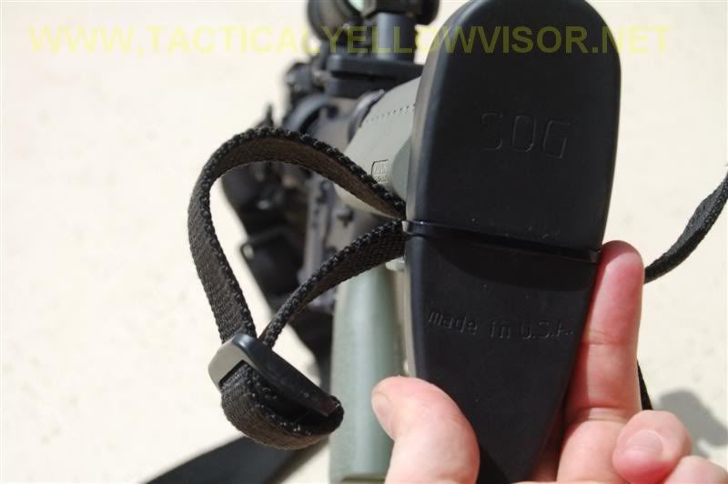

Can you take a picture of this? I can’t, for the life of me, figure out what would be causing your trouble. You should be able to strip the tail down until it’s nothing but webbing and one slider. Push the webbing through the slot, through the slider, back through the slider, and back through the slot. If you keep one slider further down the webbing you can secure the tail of the sling with it.
Here is the proper way to install as per directions

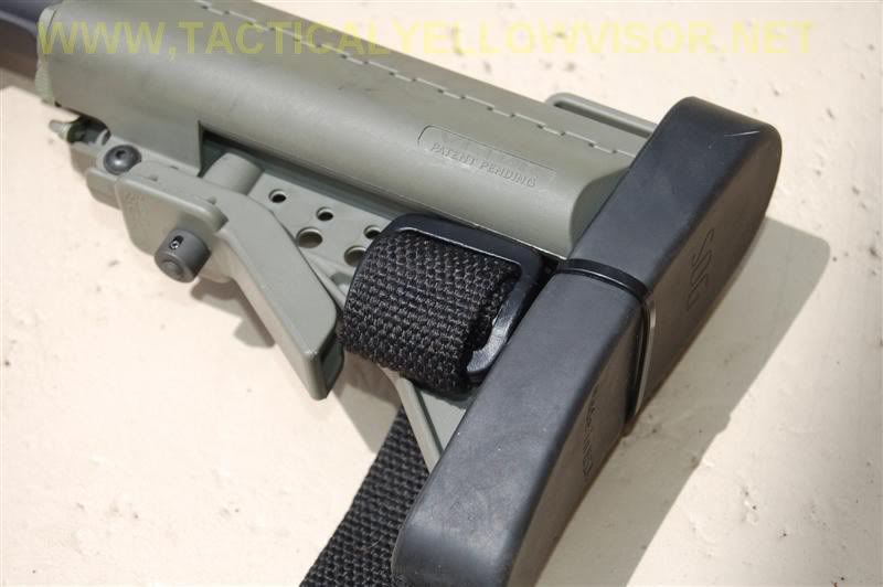

Here is what my head & cheek are competing with
Here I rig it the same, but on strongside of stock &…
And it always ends up slipping behind butt of stock and I mount into buckles

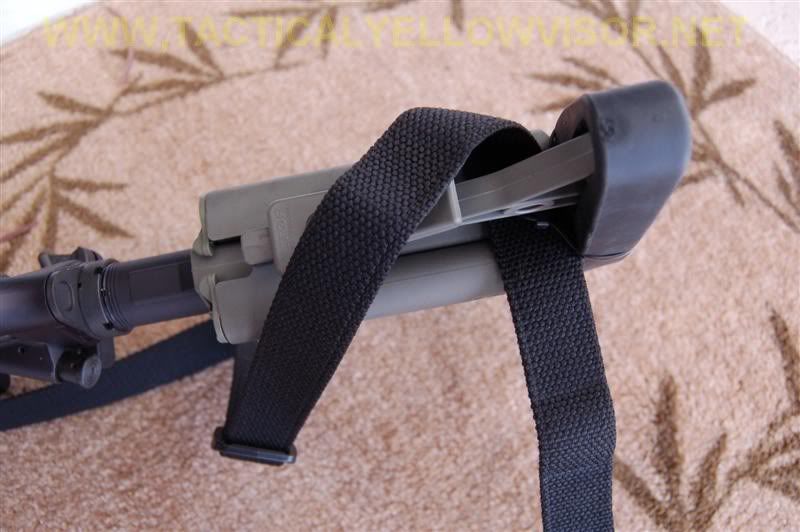

Here I try and thread the webbing thru slot and around thru top slot, no work too short
using a QD swivel in the swivel hole isn’t much better.
I personally do not think QD swivels are very “QD” and do not trust them to not get gummed and stuck in or not able to re-insert in dusty/sandy environments, so I was hoping the QD buckles on the VCAS would work.
Gotcha. I don’t use the buckles or the QD swivels anymore. I just thread the sling itself through the stock. If I use a buckle at all I put it at the front.

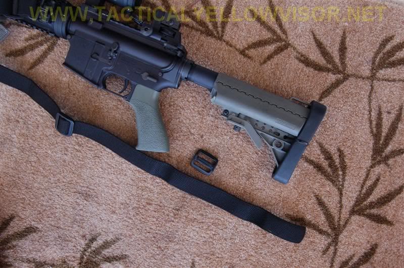

You’ve got the sling installed backwards. The quick detach is supposed to be in front, not in the rear.
The BFG instructions show the quick detach in the rear.
hmmm; it would appear Ashley redesigned the sling. I have 10 of the VCAS slings on various long guns and all of them have the detach in the front.
If thats how the slings come now, I’d either flip the sling around or just drop the detach point.
The instructions with the sling show it attached in the rear and BlueForce’s Video shows to specifically put the QD in the rear

NCPatrolAR,
You are correct, there was a redesign. Slings use to come from the factory with the quick detach buckle up front. Now they come with the QD buckle on the rear portion of the sling.

Hope this helps. Note, no buckle on the rear. Best bet, IMHO, is to either attach it at the front or use a QD pushbutton at the front.
