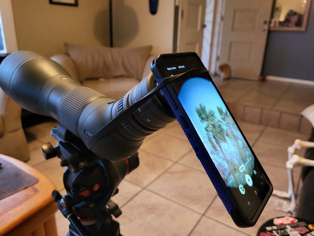

My friend was playing with his phone skope adapter while we were at the range today. I should have tried to shoot a 5-shot group, but ended up moving to other targets on the range.
Target on the left, using N133 and 75
My phone adapter is a rubber band a section of titanium pipe. :sunglasses:
That works!
I was planning on building my own with a short section of scrap PVC pipe and a phone case I picked up in the clearance section at Walmart for $1 :grin:
My phone is so out of date, that the companies who make adapters don’t have them. I had to improvise.

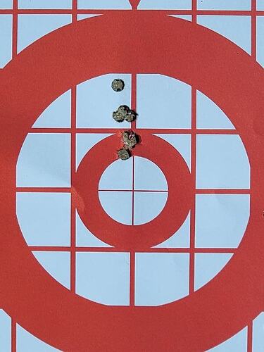

While sighting it in at 100 yards with the 77SMK/N133 load yesterday, I was really impressed by the accuracy of the barrel and the load.
100 yard groups. Top shot is the first shot, then I dialed down 1/2 minute, fired 3, then dialed down another 1/2 minute and fired 3.
