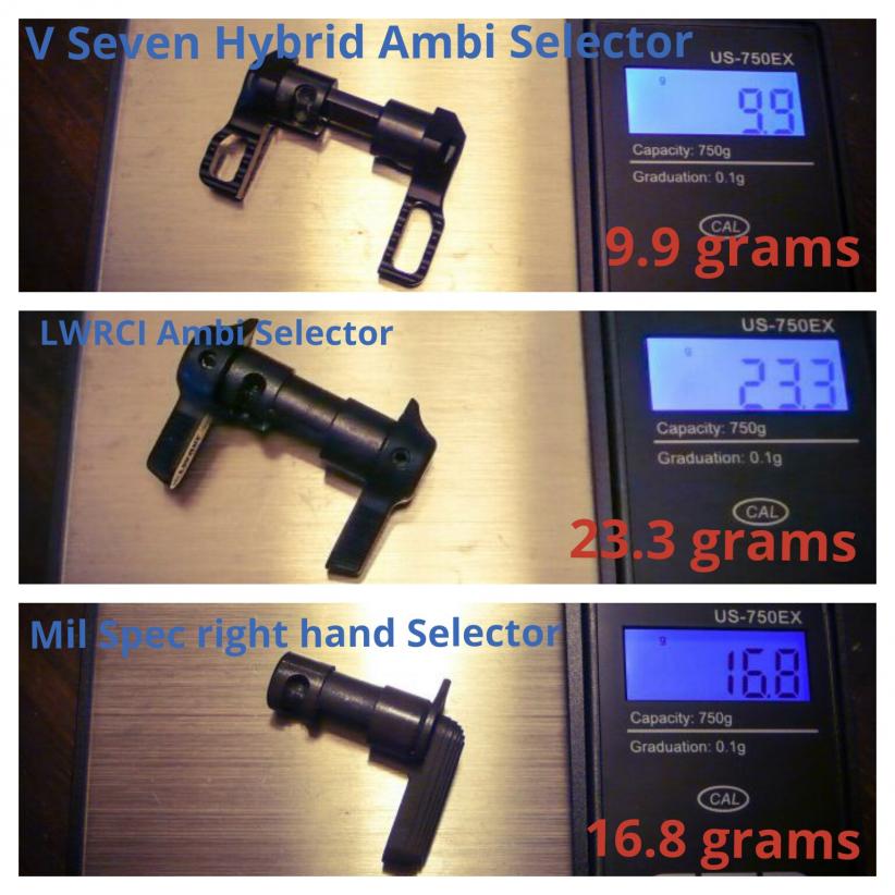

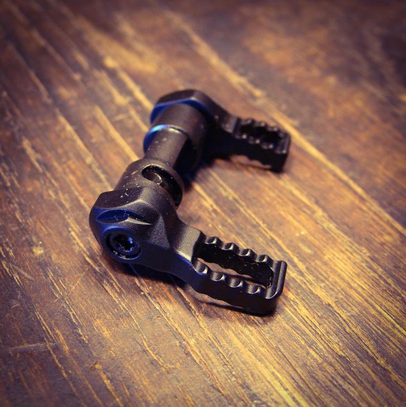

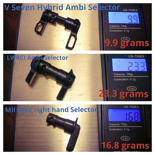

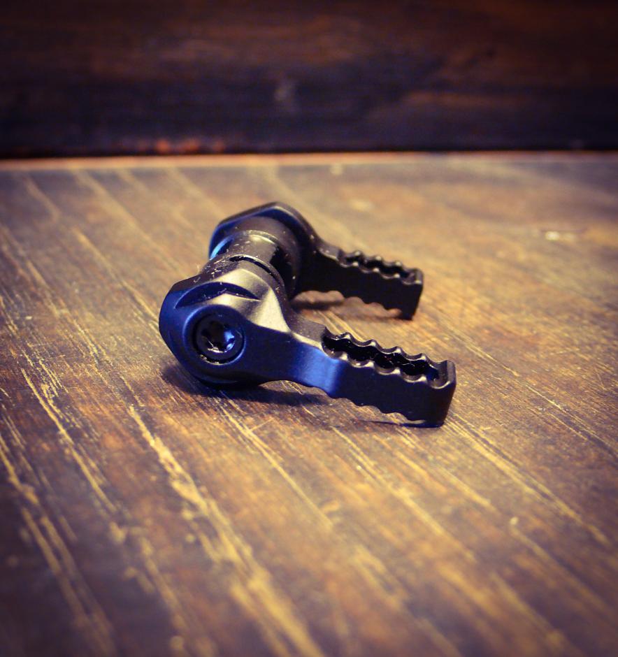

Taking the selector out of it’s packaging, you could immediately see the quality of machining and craftsmanship. In the hand it felt like nothing weighing in at just under 10 grams. The levers are machined out of 7075 T6 with a a nice type III hardcoat anodizing. The levers have a good aggressive texture with milled out centers.
Instead of anodizing the core, V-Seven chose to do the center titanium core in Diamond Black Ionbond coating.
For those not familiar with Ionbond coating, Diamond Black is one of the new
patented and trademarked 1-2 micron thin, high heat, low friction polymers that hardens and adds lubricious protection to the metal and finish.
Another positive attribute of the 57/90 degree ambi core is that it is interchangeable between the 57 degree short throw switch and the standard 90 degree safe to fire position for the more traditionalist minded. Switching out from the 57 degree short throw to the mil spec 90 degree is as easy as a #10 Torx and a screwdriver.
