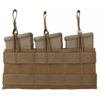

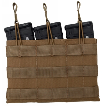

Using TT 20 Round Mag Pouches w/ 30 Round Mags
TT makes these 20 round mag pouches here -
And the 30 round pouches here -
I am thinking about using the 20 round pouches as they give you more real estate to grab the mag.
The question I have, is it too much real estate? Has anyone run these on the front of a vest and had problems?
I have thought about doing the exact same thing, my only concern was the the retention cords (not a clue what they’re called), and how they might function if 30’s were used.
One of the best inexpensive purchases I’ve made in the last 2 years is a roll of desert shock cord: http://www.supplycaptain.com/index.cfm?fuseaction=product.display&product_ID=25&ParentCat=16
I’ve lost track of all the little things I’ve used that stuff for. Replacement zipper pulls, belt keepers, the uses are endless.
The shorty pouches for 30s are very likely to work very well for you, unless you’re jumping out of planes. That requires flaps and whatnot. Not having enough cloth real estate is unlikely to be a problem with these. Get some shock cord and replace the existing retention with longer; all it takes is a pair of scissors, a lighter to fuse ends, and some overhand or figure-8 knots
