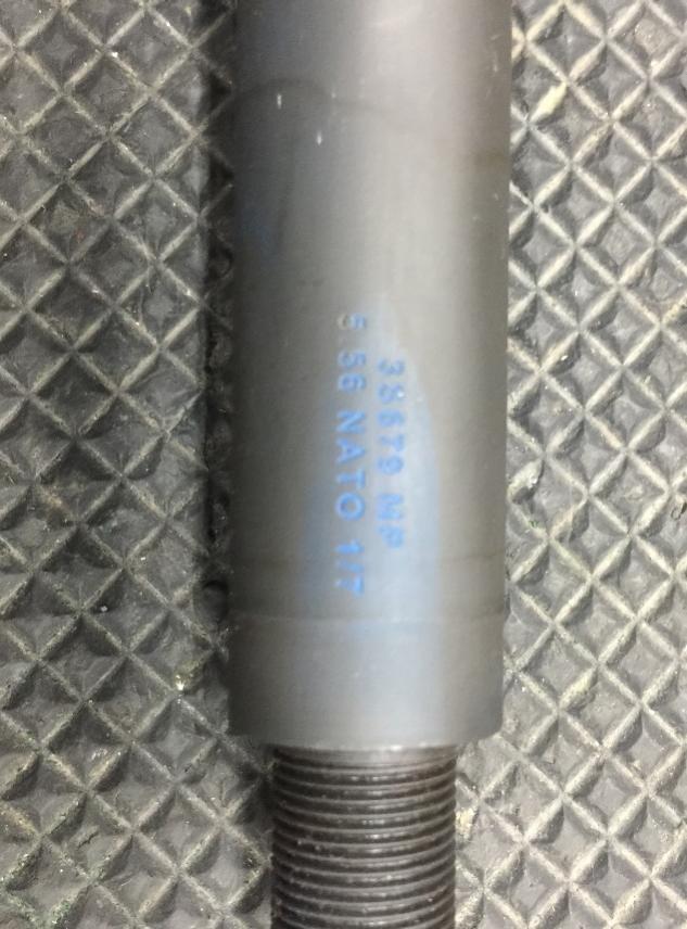

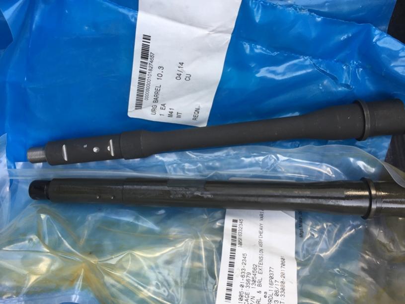

Difference between Crane’s cut down 10.3" Govt profile and FN’s new 10.3" SOCOM bbls. Gas port is a measured .070"

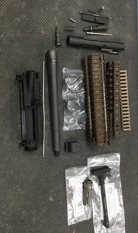

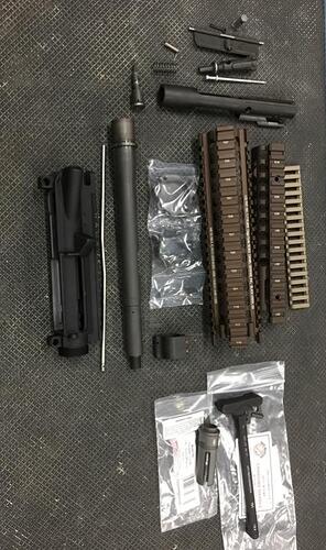

The parts: FN bbl, upper, BC and bolt, DD RIS II Mk18, PRI CH, SF4P FH and KAC front sight. Rest of parts are all govt contracted. Only thing that’s used was the Forward Assist, almost selected a teardrop M16.

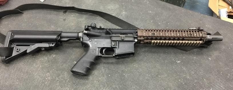

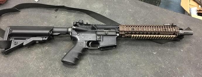

Assembled and installed on select fire lower w/SSF trigger. Second we built this week with FN bbl. Bit heavier up front of course.
