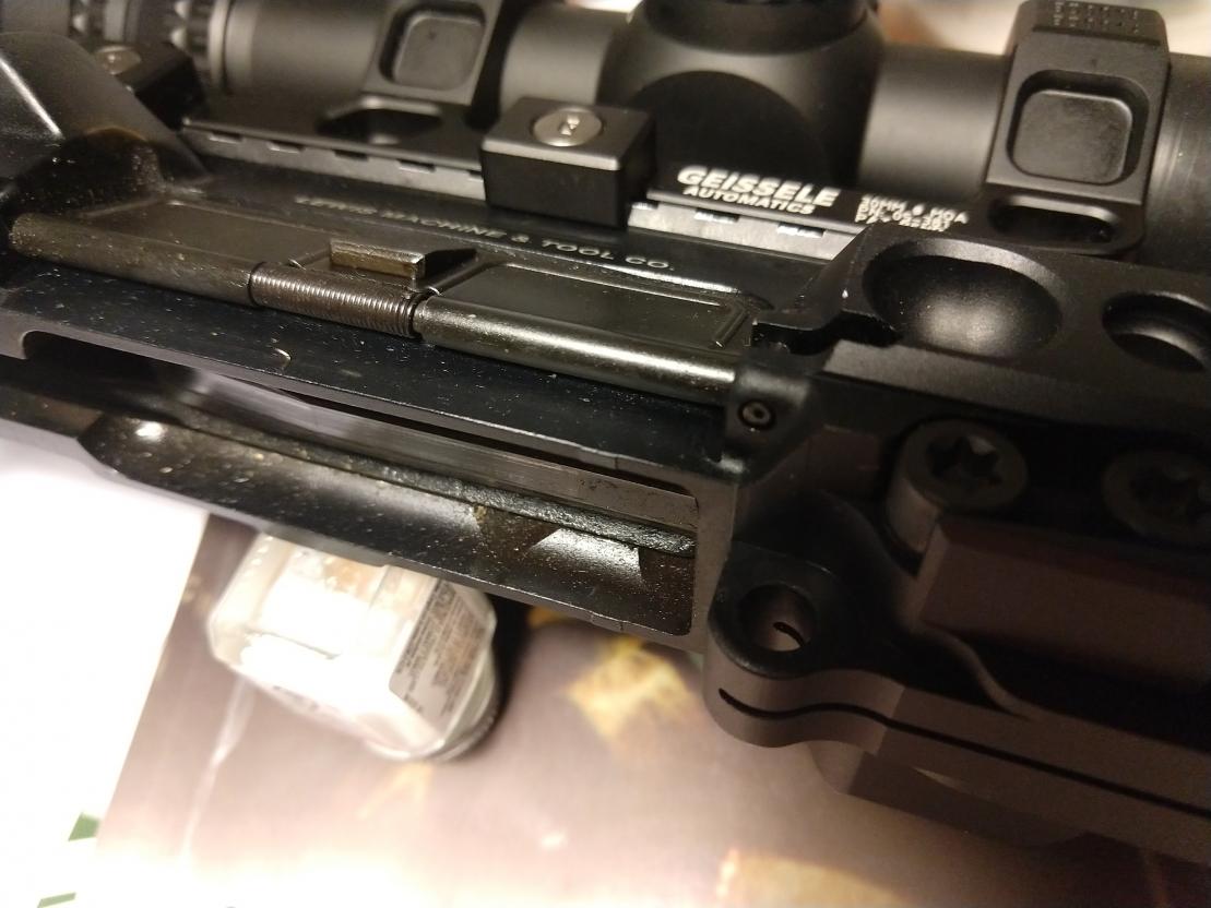

To the OP, are you attempting the front pin hinged or flat? I bought an MRP upper last year from Fin which shipped directly from LMT complete. This upper is extremely (uncomfortably) tight on my newest and unused non-MARS lower, and fits very close fit on lowers with more time. LMT is machining pads into the upper which I believe by design are supposed to tension the pair a bit so the top and lower half are tight. Shooting teams would do something similar by taking a piece of shell casing and shimming between the two. The pads are about .75" back from the front pin, and are ~.005 thick. Pic attached:

I’ve experienced tight fits with an occasional BCM UR here and there, but nothing like the MRP and that newest LMT lower. I do believe they would wear in and be fine, but the pads may explain the difference between your standard uppers (Vltor and BCM) and this MRP upper. It was just a data point I’ve not seen anyone else mention.
