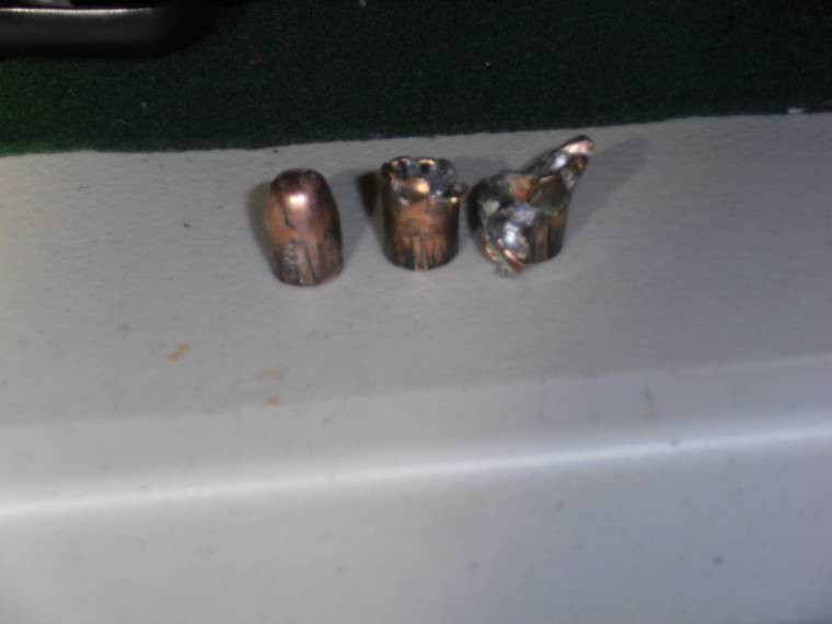

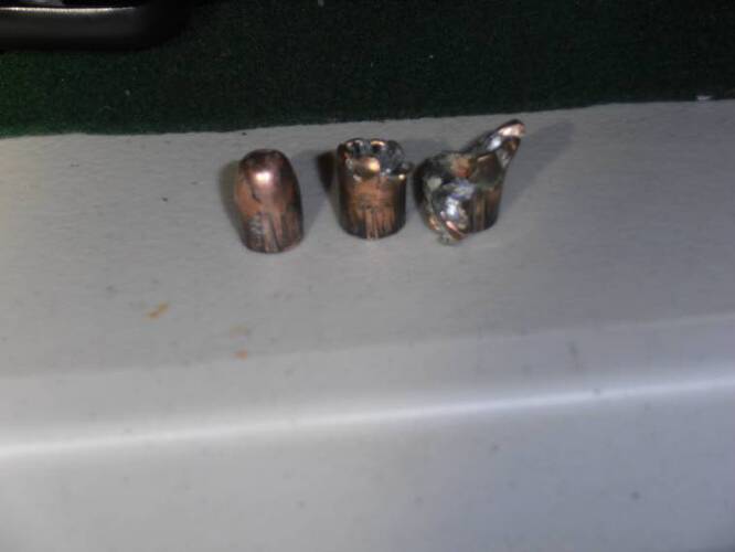

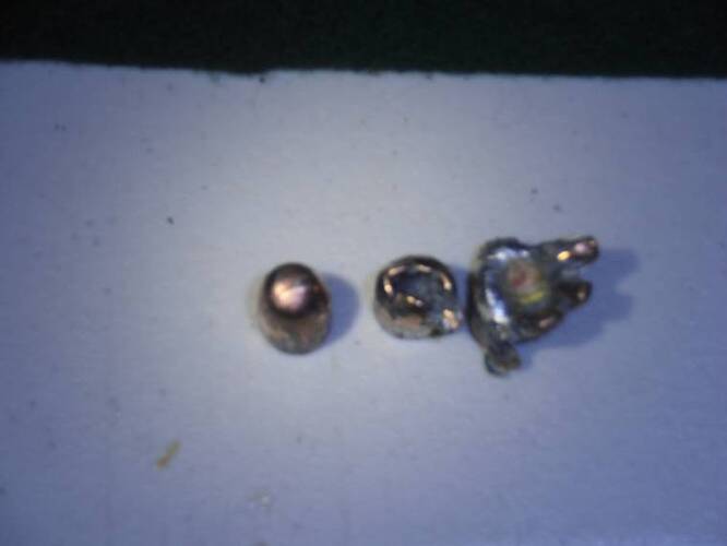

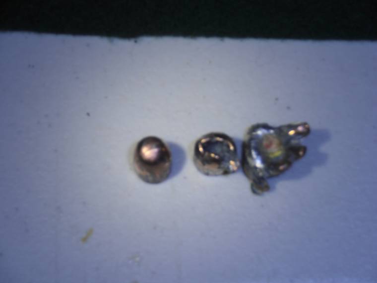

Picture of recovered rounds below.
Left to right, 230gr Federal Ball, 230gr Magtech Bonded JHP, and 230gr Winchester Ranger T.
Conclusion: Well again, not scientific at all, just base observations to see what could be expected from the round and compare it to a round that is proven. Firstly, the Magtech round with it’s wider cavity did clot up and not nicely it took a good bit of effort to remove the paper that was trapped in the cavity. I should have taken a picture before I started screwing with it, but I had expected to be able to recover more rounds and have a better than sample of one, and lord did I work to get that sample of one today. Will, next time, take a considerable thicker stack of books or perhaps by then will have a place where I can get away with water jugs or something. A chronograph would be helpful as well, and that is on the list for the upcoming year so… That said, at the moment I am still going to stick with more proven rounds like the Ranger T that I have currently in my inventory. Again, not bashing the Magtech round, and not writing it off as of yet since I would still like to do some more testing and see others do some testing as well as compare it to other rounds like the Speer Gold Dot shown.
