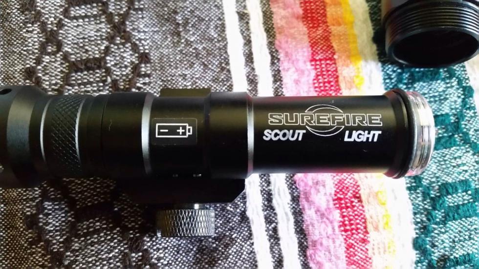

So I purchased an M600 Intellibeam from B&H Photo (a seemingly solid company that I have done business with in the past). They have a “used department” and I found this light for a good price. The condition was listed as “Open Box, like new, full manufactures warranty”.
The first thing I noticed was that it is NOT the intellibeam head…but the surefire packaging and user manual is correct. Then I noticed the head has one of those Chinese-style magnifying lenses and no reflector. THEN I noticed the switch is backwards…there is no momentary on…you have to click all the way, then you are constant on…when you press it a bit, the light goes off. It is basically, “momentary off”
Anyone seen anything like this before?
Surefire uses TIR lenses, not reflectors, so that looks OK. I’m surprised you were able to unscrew the head like that, though.
The lack of momentary/click for constant on is strange, though. A lot of cheap copies have the switch logic reversed, like you have described for your sample. I wonder if someone purchased the intellibeam, then got a knock-off from eBay and put it back in the packaging and returned it. B&H wouldn’t know the difference.
Also, the little battery sticker is something I have never seen. I have a dozen brand new M300C and M600U here and none of them have those stickers.
Oh, and the latest M600U has a head labeled KE2-A, not KE2-C.
Edit: Is the image showing the front of the lens with the light fully assembled? If so, that does look odd. You should be able to see the LED through the front TIR lens on a real Surefire head.

Yeah, you definitely cannot see the LED when the head is fully assembled…and I have never owned an LED Surefire that allowed you to access the LED like this one.
There is also a lack of serial number on the main body, and no “www.surefire.com” on the tail cap.
It’s gotta be fake.

Yeah, this is for SURE not an intellibeam head.

That is definitely not a complete Surefire product. The head alone should be enough cause for a full refund. Let us know what happens.
