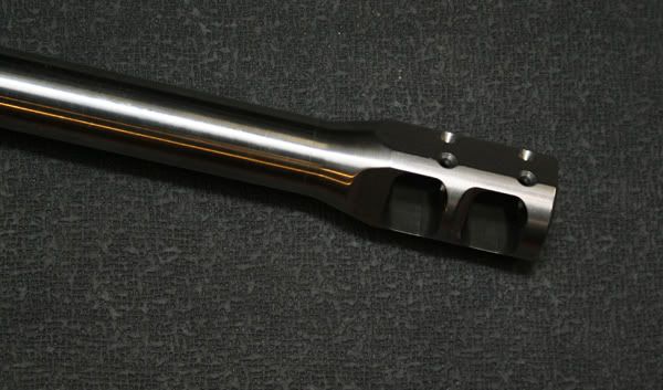

For a friend of mine I had Drew (W.A.R. rifles) turn his DPMS stainless 20" bull barrel to .650" and install a huge JP Bennie Cooley brake and he has no problems. That rifle recoils flat like a .22LR.
