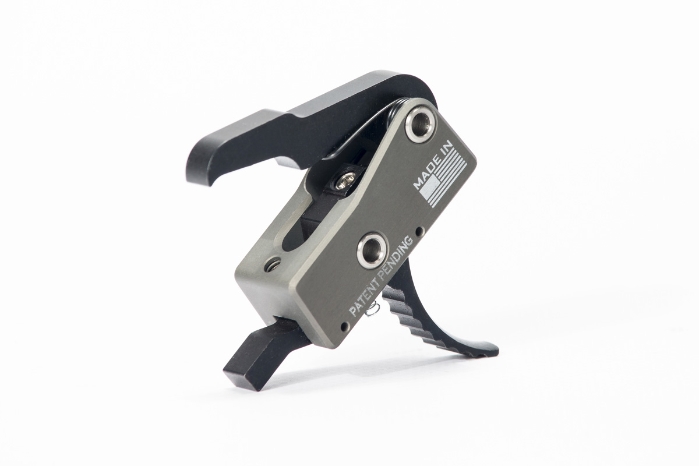

My favorite trigger for toys used to be the SD-3G but I recently picked up a KE Arms SLT-1 and like it better. With a coupon code I paid $168 shipped including an ambi safety, significantly less than the Geissele.

The KE Arms SLT-1 is a significantly different design than a typical trigger. For example, it doesn’t have a conventional disconnector.
As far as I’ve seen, basically all AR triggers are minor variations on the same basic geometry. This isn’t.
https://www.youtube.com/watch?v=DjkSqvRcjlk
Not sponsored by them or anything, just a happy customer.
