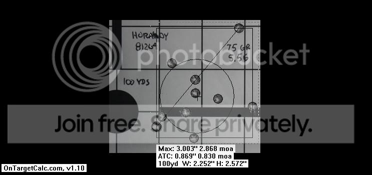

You should perhaps think about using a precision calculator in the future to better help you analyze your groupings. I recommend OnTarget and have a thread that has the free download in it if you do a search.
Here is your 81264’s group measurement…
Thanks!
I’ll search for that program to download.
I didn’t know there was something free that could do that for me.

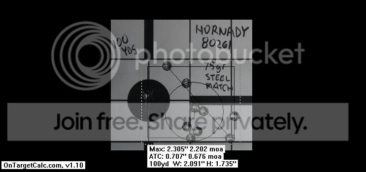

Here are the rest of your group measurements…
HORNADY 80261/ 75gr. Steel Match
