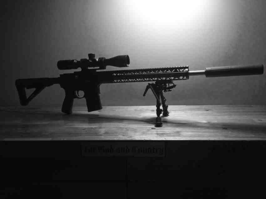

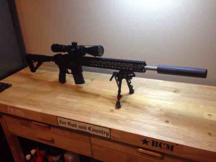

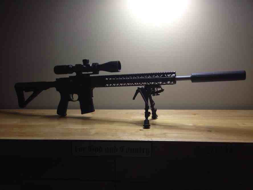

Finished up for the most part, waiting on the Syrac gas block to come in tomorrow. The gas tube flare at the bcg needed a few thou taken off. Had issue of the bcg not going in to battery due to the gas block. When I got to pick up some small parts (finishing my spare parts kit) I’ll grab a gas tube for rifle. I fired two rounds for function, tomorrow range time!
Rainer Arms Force 15 inch rail
Rainer Arms Match barrel 18inch rifle gas length.
Using tapatalk
Nice! Might I suggest a SOPMOD or STR stock for a better cheek weld. You won’t regret a nice, comfortable stock for a rifle like this. What trigger did you end up using?

Thanks! Yes that is on the list, I’ve been wanting a SOPMOD for a while, to later throw on my other rifle. STR would be the ticket through. Trigger I used is a SSA, does not fit the role so much but is alot better than trigger that comes from BCM or Daniel Defense (DD being my go to rifle). The build above is using BCM lower and upper.

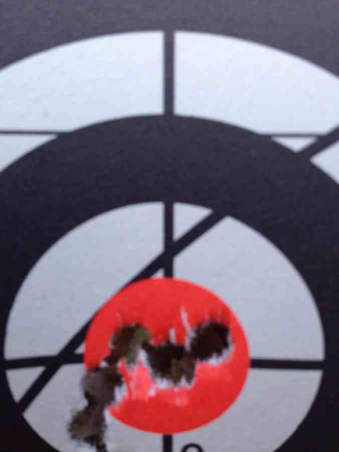

I’ve got to get a better trigger. I mistakenly grapes the wrong lower with the mill spec 6 pound trigger. Good thing about it is it make it harder and this I had to concentrate harder in my shots. I put 40 rounds through it 10 for zero 15 for group and rest were banging steel at 200 yards ( 2/3 man size and 2 5 inch gongs.
I’m very green to the precision thing. I do need a better scope, have a primary arms FFP 4x14. May pick up a vortex in the same flavor, heard great things about them.
