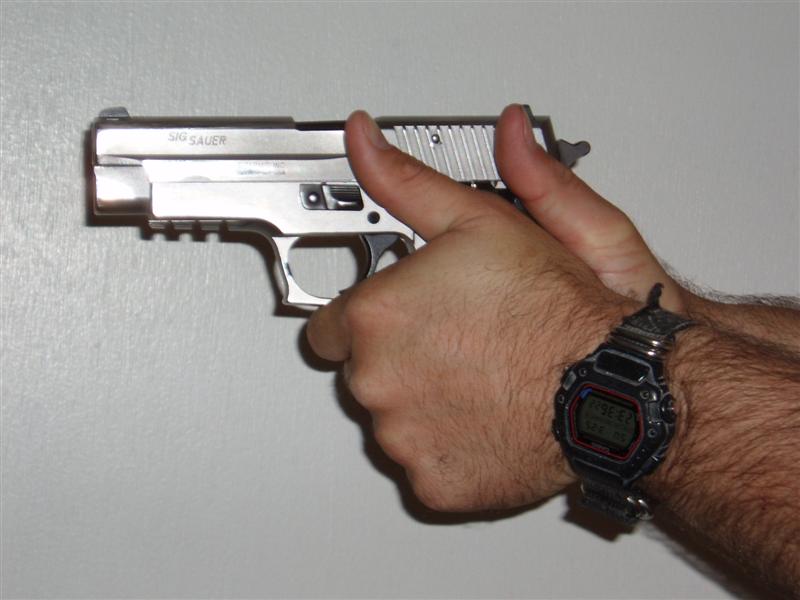

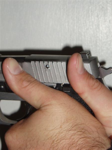

http://www.youtube.com/watch?v=FIlDZUiBVvI
5:30 I talk about the issue in general. 7:40 I reference Sig Sauer’s in particular and how I modify the thumbs forward grip as mentioned above. I am traditionally a 1911 guy and I learned to run my thumb tight to the slide on top of the safety, but I have been carrying an issued Sig for over a decade so an altered grip was a necessity. After a decade of running an altered grip, it comes pretty normal now.
