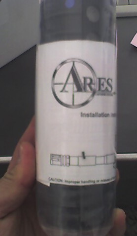

The below picture would NOT inspire me to make a purchase.
In this day and age Stick’, me either…

Some of you who judge the product by the quality of the photograph might want to read what Dennysguns has to say about his personal experience with this retrofit in that other forum.

Long term support, and durability of this product is still to be determined, and it isn’t because of the picture.
