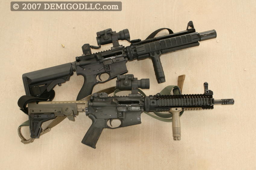

As a point of reference, Zak Smith’s gun (bottom) has a Noveske 12.0" barrel with a LaRue 10.0 rail. So with a 9.0 rail and the 11.5" barrel, you would have 1/2" more barrel exposed:
-Jeff
