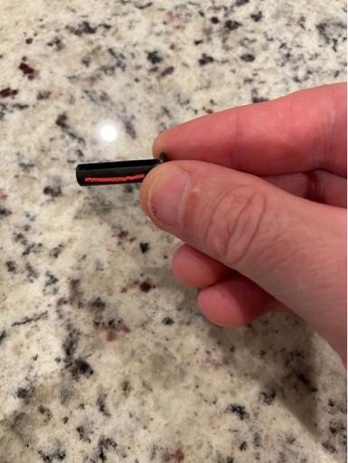

I got out the Dremel and ground one section of the takedown pin flat.
Problem solved

Any chance you could provide a photo of what you did to resolve the problem? It might make it easier for other down the road to understand it.

Sure (once I get up to speed on posting pics). It will be on the spare pin though. The original is back on the lower with the upper back on it.

I Dremelled this part (red line) flat
