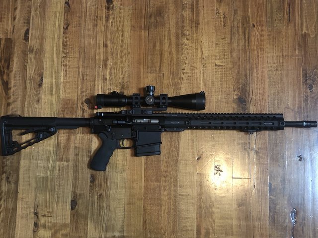

Here was the end result of the first build with the TM10.2 receivers. The only thing I’d change is the stock. He’s happy with it so whatever.

Looks great!
Maybe a LaRue RAT stock, or the good 'ol MFT Minimalist.
Nice build.
Thank you sir.
