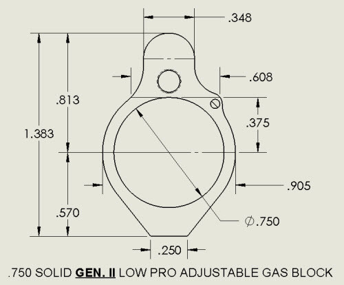

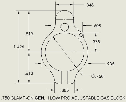

Here are a couple pics showing the dimensions of the Syrac Gen. II Gas Blocks for reference if someone has a Lite Rail mounted and can compare their gas block dimensions to these.
Syrac AR15 Gen. II .750in Adjustable LP Gas Block (Clamp On) Dwg.jpg Syrac AR15 Gen. II .750in Adjustable LP Gas Block (Set Screw) Dwg.jpg

I’m running one (set screw version Gen II) under my Mk18 RIS II and it fits just fine. The RIS II has a listed I.D. of 1.15". A clamping version would actually fit with the RIS II as there is a cutout in the rail where the gas block sits. I don’t know if this is the same with a LiteRail II.
Thanks colter, that tells me what I needed to know. The Lite Rail I & II have I.D.s of 1.22", the Lite III is only 1.08"
So I should be golden putting a Gen. II Block under a Lite II.

After looking at SLR’s site, I would tend to say that an SLR would fit under a Lite or Lite II. As for a Lite III, I am doubtful and another user posted above that his SLR wouldn’t fit under a Lite III.
Caveat: I do not have an SLR block here to mic, I am going by the 3 dims they provide on a drawing on their website so I may be wrong.

As for my friend Eurodriver, I am told by Jason Adams of Syrac Ordnance that the .750" Gen. II (screw or clamp) will fit under a Centurion C4 rail. The Gen. II should have no problem fitting inside a 10" KMR (BCM, I assume) since the KMR I.D. is 1.3". Gen. I Blocks look like they may be a different story, especially the clamp-on - so that’s your risk to run.
