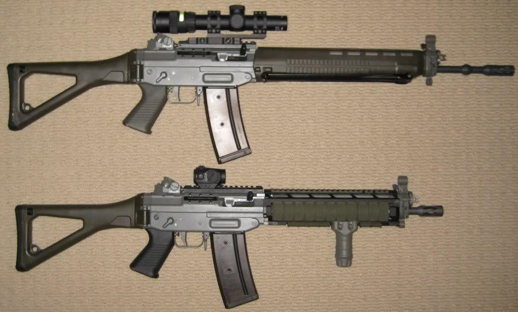

Guys,
I know you can’t own this line of rifles, so just thought I’d show them off. ![]()
Out of curiousity, does anyone know if these uppers attach directly to a 556 lower? I was thinking about importing one up here to make it accepty AR mags.

Yes, a 556 lower will fit without modification. However, the 556 trunion has material relieved from the rear/lower aspect of the trunion just below the feed ramps in order to allow the AR15/M16 mag to appropriately clear and fit. Mapgul P-mags will work without modification, though they will fit rather tightly and will not drop free. USGI-type aluminum mags, HK 416 mags, etc… will not work as they hit the bottom edge of the trunion in the Swiss Arms 55x and will not seat. P-mags and Thermolds will work without modification, but
Here is my SIG/SAN 551-2 with 556 Classic lower and Magpul E-mag. It functions perfectly, though as I mentioned the mags are a tight fit.
