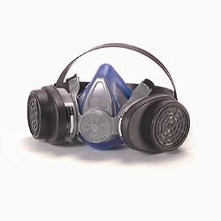

You could just get one of these:
I’ve seen people shooting with these things at the indoor range. I believe the activated charcoal filters capture airborne lead and other contaminants. Obviously you can’t really shoot a rifle with the model pictured, but you should be able to find smaller profiled ones if you look around. You can also check out your paint stores for these.
LOL. I’ve actually thought about trying my gas mask. But I’m afraid that it might scare the other shooters. :smiley:
