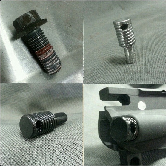

I have RTV on all of my charging handles. I still get a little bit of gas. I recently made my own gas vent to use instead of the FA.
I will see how well it works. I think it will alleviate any rearward gas spray.
It’s not very pretty, but it should work well.

OMG - franken-bolt-vent!
