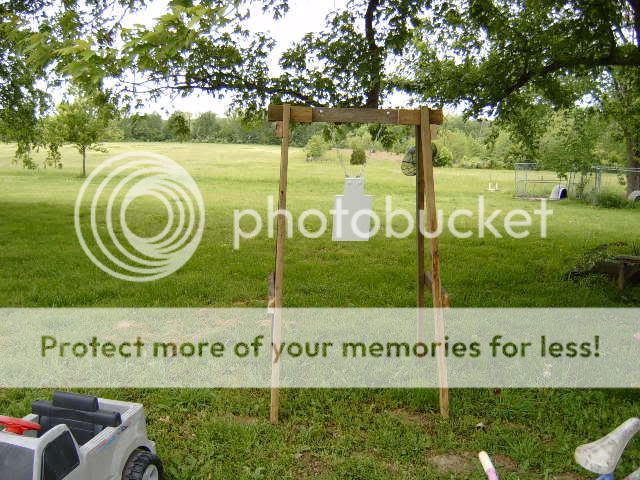

Then I took some chain and bolts and a little treated lumber and built these.
