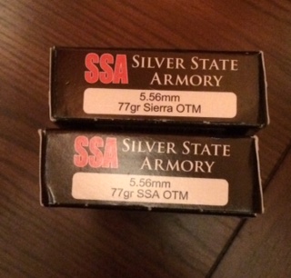

Once I got home I found that the two SSA boxes I purchased today were labeled differently:
However the hollowpoints of the SSA loads look similar. In the photo the SSA are the rounds at 3:00 and 9:00. The 12:00 round is IMI “Razor Core”/SMK and the 6:00 bullet is my handload with a 77gr SMK.
