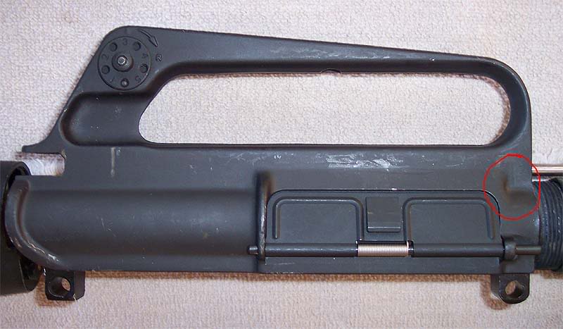

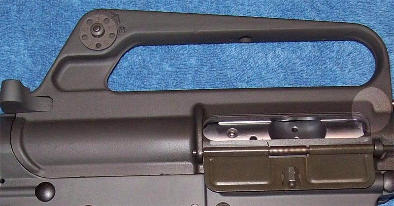

I have an upper receiver that looks just like yours; judging from the left side I think yours (and mine) are round forge uppers but just barely.
The upper receiver forges were only good for a certain number of castings before they were too worn to be usable. They would have to be re-worked or replaced, so not all uppers are going to be exactly the same in terms of their lines. Square forge uppers were only used until 1966 (?) I believe, so certainly thousands of square forge uppers with a forward assist were produced, but round forge 603 uppers are were produced in far greater numbers.

Round Forge:
Square Forge:
